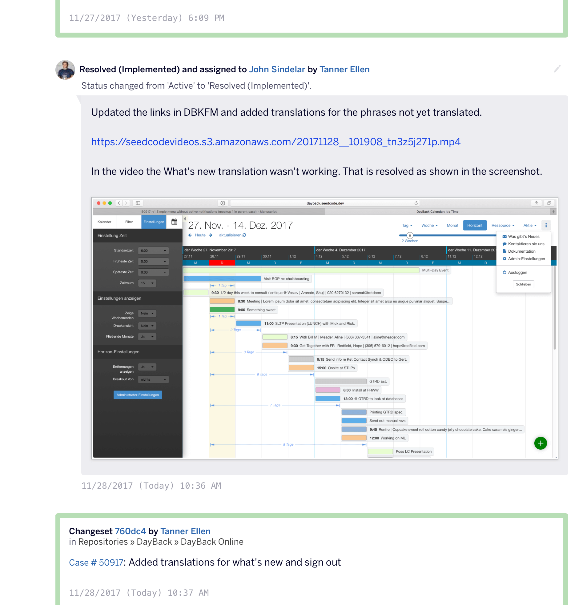

  • When we comment out or change code in a script or in a calculation, we include a note in the comment about why we did it.
  • If work is related to a Manuscript case, we include the case number in the comments: it’s amazing to be looking at an If() statement you don’t think should be there and see this telling you exactly why it’s there… “If filter is not empty and field DOES NOT match this source: Case 30325”. Now you can go read that case and see the real-world situation that required the If() statement.
  • When we’re building a new feature and we decide between competing alternatives we write about that in the case or in the product docs. (For an example, see “Why Make This a Switch?” toward the bottom of the article here).
  • Sometimes we start docs for features that haven’t shipped yet so we have a place to record the details of implementation as we’re creating them. It’s much easier to jot down these details as we’re building than to try and reconstruct them later.
  • In FileMaker, any script that’s changed gets the Manuscript case number related to that change added to the header comments in the script. For products, we also include the build number we’re working on. This means that if we want to see all the scripts changed in a particular build, we can just use The Tool to search for the build number across all our scripts. (We used the FBz prefix when Manuscript was called “FogBugz”.)
  • And all commits to our repo (we use Kiln and GitHub) should include the case numbers related to that work. When we do that, our commits flow back into Manuscript, linking the commit to the customer. When we’re reading back through cases and wondering if we really solved / shipped this, the case numbers help us know for certain if and when we shipped a fix/feature.

But all of these strategies are about creating a path from the customer’s cases (or feature specs) to the code that addresses them—a path that our future selves can follow. Creating a path means making links between things, not just comments. So paste in URLs and case numbers along with your comments.
Having a path reduces restart time and increases role portability. Meaning your organization (not just your code) is less fragile: less susceptible to schedule changes, minor emergencies, or one of your developers just having a low energy day.
