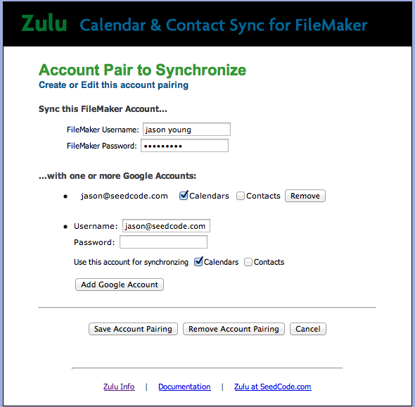

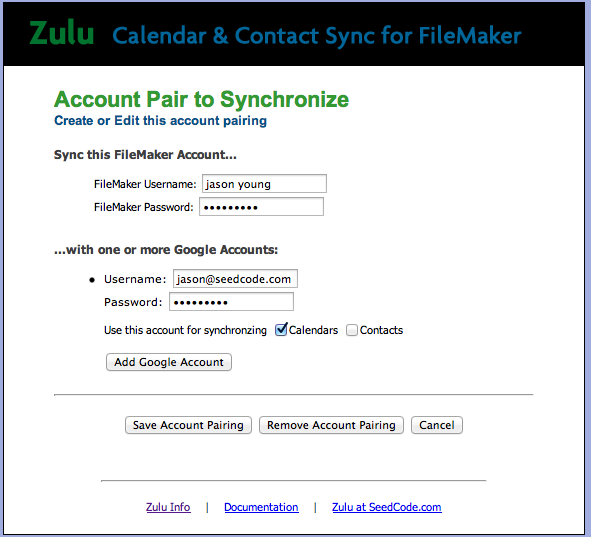

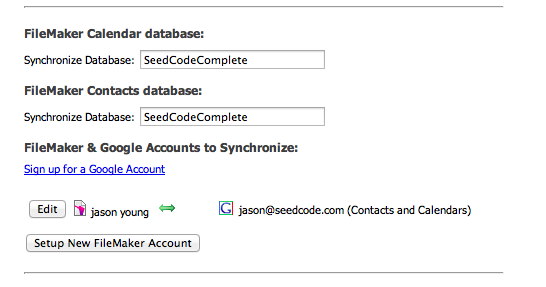

First Screen you enter the FileMaker and Google info and select the appropriate checkbox:
Then hit Add Google Account so it looks like this
(This is because you can pair with multiple Google Accounts):
Then hit the save account pairing, and you should be good to go so it looks like this:
I would start by selecting the Remove Account Pairing option to make sure you're starting from scratch.
Let me know if that helps.

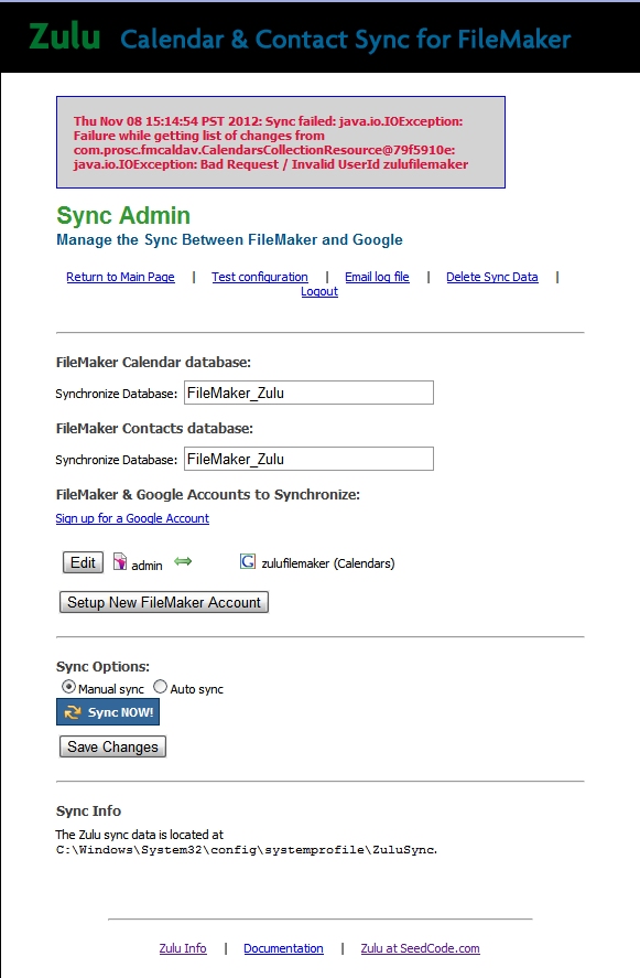

Posts: 10
Joined: Tue Nov 06, 2012 4:00 pm
PostPosted: Thu Nov 08, 2012 3:59 pm
Thanks Jason - It's all working now. I was having a problem with a new google account I created for testing the sync. I was receiving an error message that it was an invalid account. I tried pairing with another google account and it worked fine. Pretty cool.
Zulu sync.jpg (178.71 KiB) Viewed 67124 times
PostPosted: Thu Nov 08, 2012 4:18 pm
Great Chris,
It does need to be paired with the "Primary Email" of the account, so that can be an issue, but sounds like you're good. Also, remember in demo mode, Web Publishing needs to be restarted every two hours, so probably bets to keep the syncs manual if running the demo so you don't have it die during a sync.
Should I keep the ticket open about installing on the D drive, or is that moot now?
