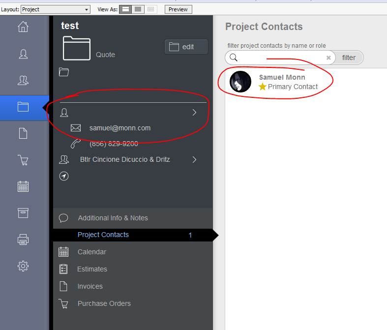

I am just starting to work on using Projects and noted, when I click the New Project button in a Contact, that the contact name is not showing on the Project, just the email and phone comes through.
It does link the primary contact, but the name is not showing. Since the email and phone is showing I assume it is an error in the programming. See screenshot. When I click on the arrow next to the name it does show the primary contact.
I even went back to the original databases I purchased to ensure I haven't made a change and it was the same problem.
I basically need to go into Edit and reselect the primary contact to show up correctly.

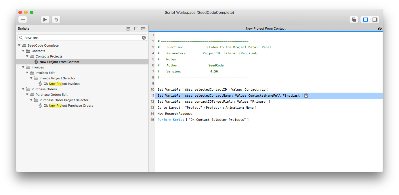

It looks like this should be an easy fix. Just add the highlighted line in the attached image to the "New Project From Contact" script and you should be all set.
Any existing projects can be fixed by clicking where the contact name should be, then selecting the contact again and hitting save.
