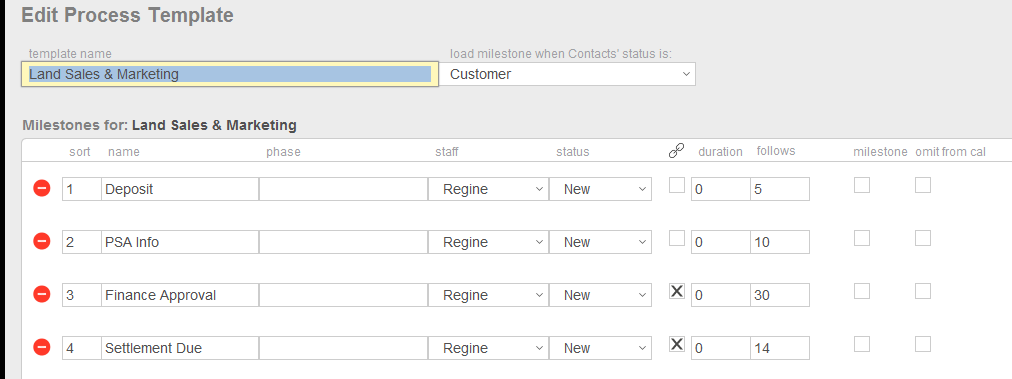

I have a milestone template with 4 events, but only the last two are linked, could that be the problem? See attached screenshot.

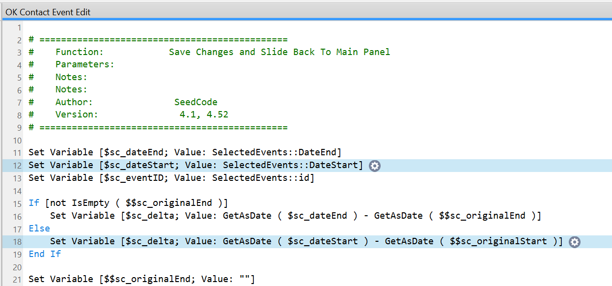

In the "OK Contact Event Edit" script, you can make the changes highlighted in the attached screenshot to have the script determine the delta from the start date. (Add line 12, change $sc_dateEnd to $sc_dateStart in line 18)
Let me know if that works for you.

Unfortunately it is still not working.

These events are from the Process Template as shown in the screenshot from the 18/01/2018, but the template is only attached to Contacts.

Events are only linked to milestone within the context of a project. When you edit the events from the Contacts layout, the scripts will check if any other events in the same project need to be adjusted, but there's no linked milestone relationship setup between events and contacts that will be updated.
If you're not using the milestones in the context of a project, and would rather have these linked milestone events considered in relation to the contacts, we would be happy to help out with that as part of an implementation package. This would require a bit of customization of the scripts and relationships in Complete, but we should be able to complete this work within a 3-hour implementation package. If you'd like to move forward with that, you can pick up a 3-hour implementation package at the following link and we'll reach out to you to get the work scheduled:
