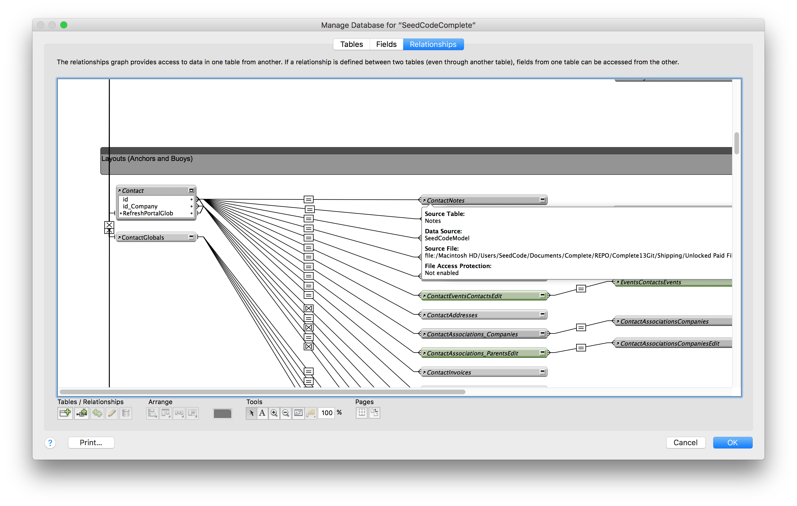

Which file can I query to generate a report of contact notes? Also, what syntax should be used to generate the report by date and active contacts only?
PostPosted: Fri Nov 10, 2017 5:46 pm
Hi Ken,
Notes are in the "Notes" table in the file "SeedCodeModel". As for the report, I'd just make a new subsummary report layout in the SeedCodeComplete file, maybe basing it on one of the existing reports like "Sales By Item Print". Base this layout on the "ContactNotes" table occurrence and summarize by contact or date. Then you can script a find for active contacts and use the GoToRelatedRecord script step with the found set option to get all the notes records for the found set of (active) contacts. Sort by contact, then date, and you're off and running.

Thanks for the info John. I was able to retrieve client notes and sort properly. Using the Sales by Item and Sales by Item Print worked extremely well. You guys have done an excellent job documenting and keeping things well defined and symmetrical. I easily added the new client notes procedure to the reports layout by following the layout design.
