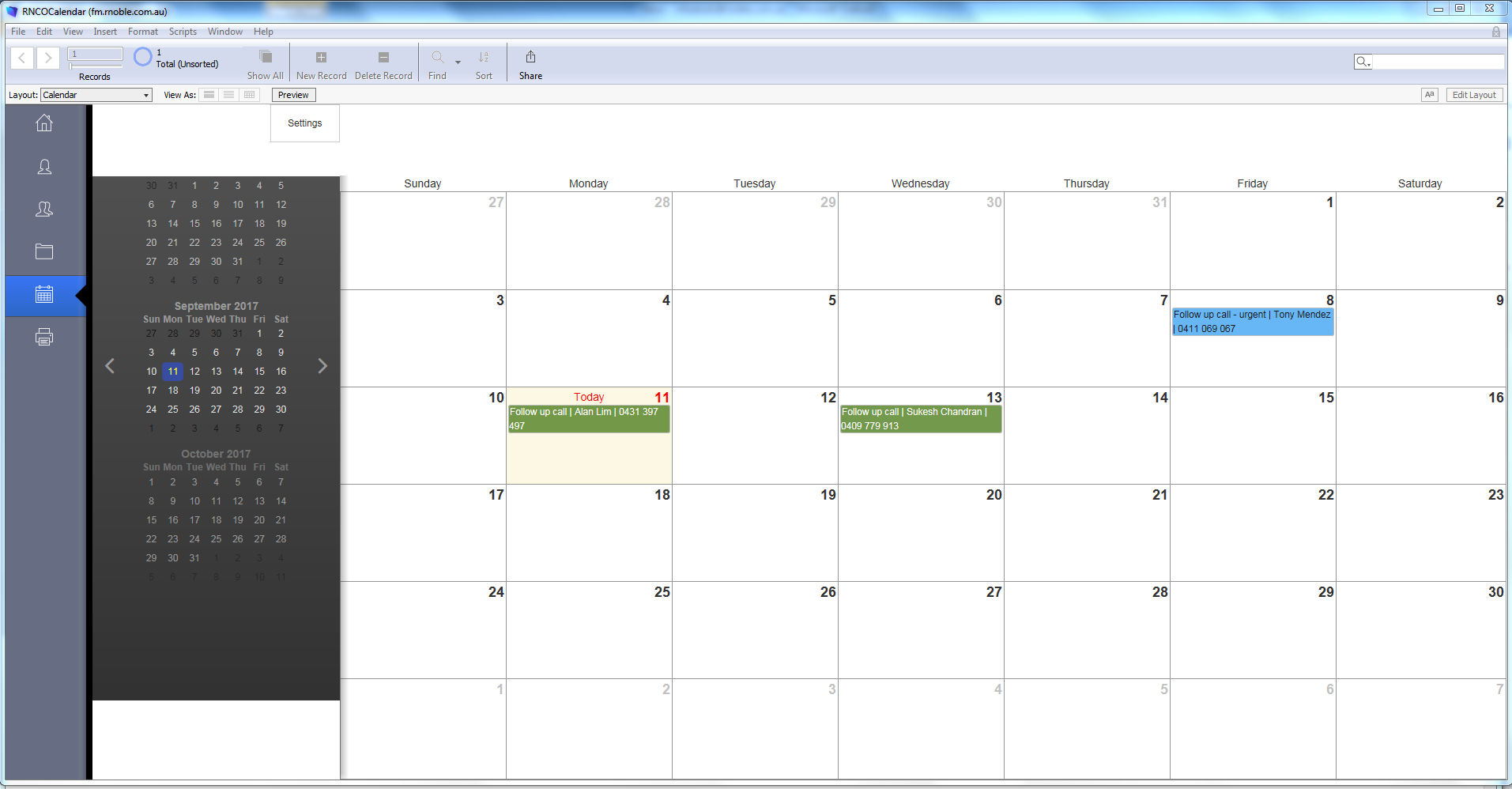

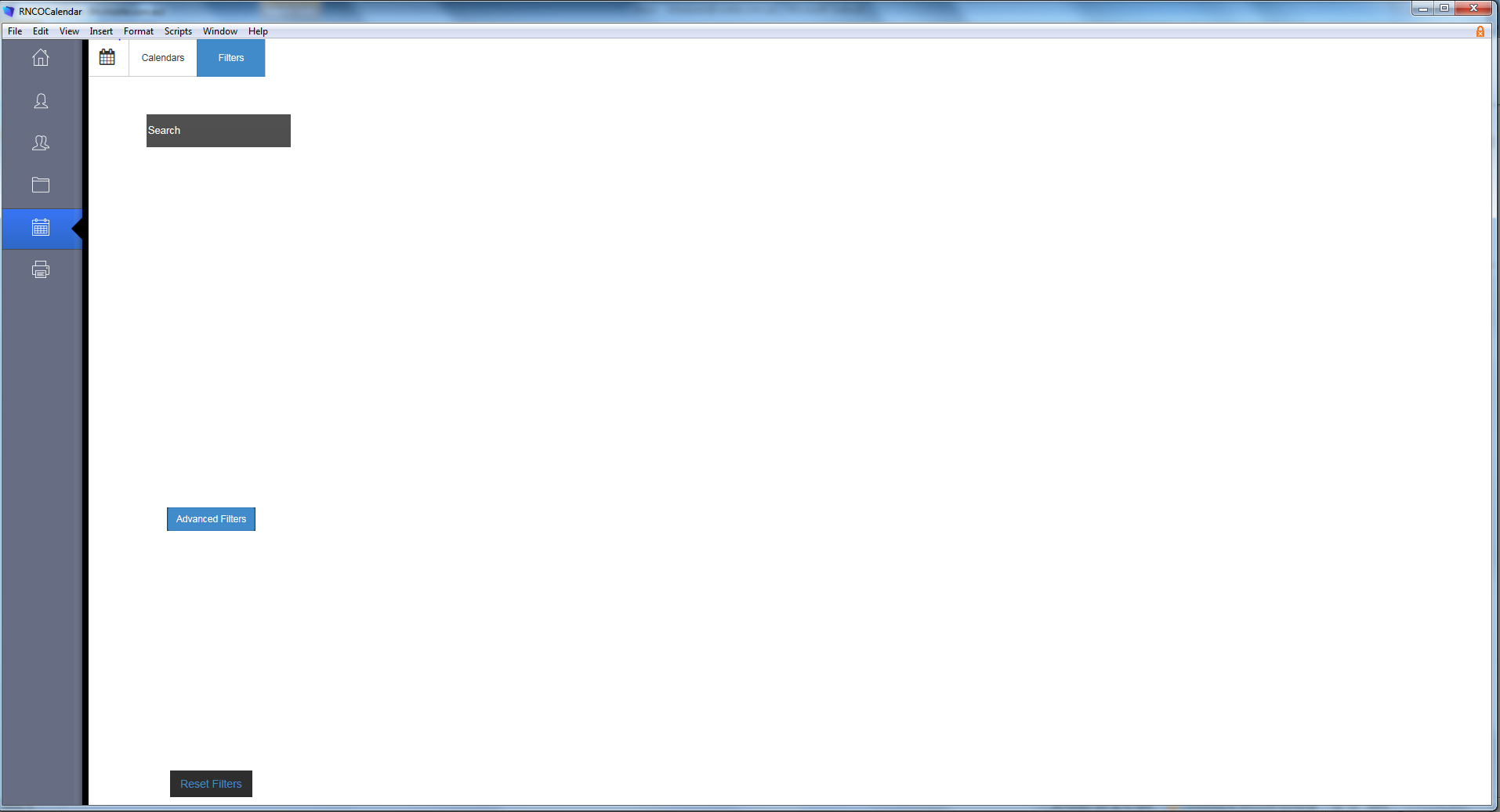

We are coming across a strange problem that the calendar doesn't seem to fully display when we switch between the SeedCode Complete and Calendar files.
Sometimes it gets so bad, that it mainly shows a white screen only, see attached screenshots. Once you hover over with your mouse it starts displaying bits and pieces, but not all.
calendar partially loading.PNG (156.49 KiB) Viewed 22810 times
calendar not displaying.PNG (115.53 KiB) Viewed 22810 times
PostPosted: Mon Sep 11, 2017 10:56 am
This seems similar to the issue in Windows when closing the event detail window described here: https://www.seedcode.com/pmwiki/index.p ... etailHangs
You should be able to fix this with the same method by adding a couple lines to your script navigating back to the calendar. These lines will reduce the calendar window width by one pixel, then adds that pixel back.
Let me know if that works for you.
