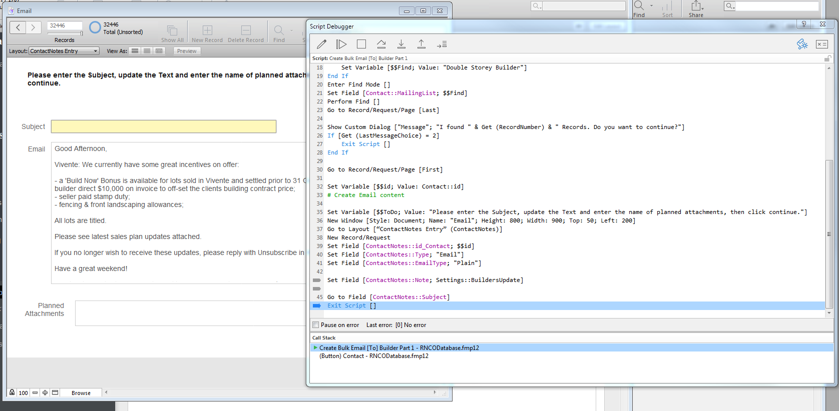

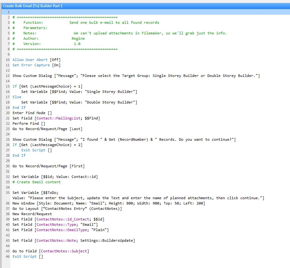

PostPosted: Mon Apr 24, 2017 1:07 am
Hi Tanner,
Thanks for your message.

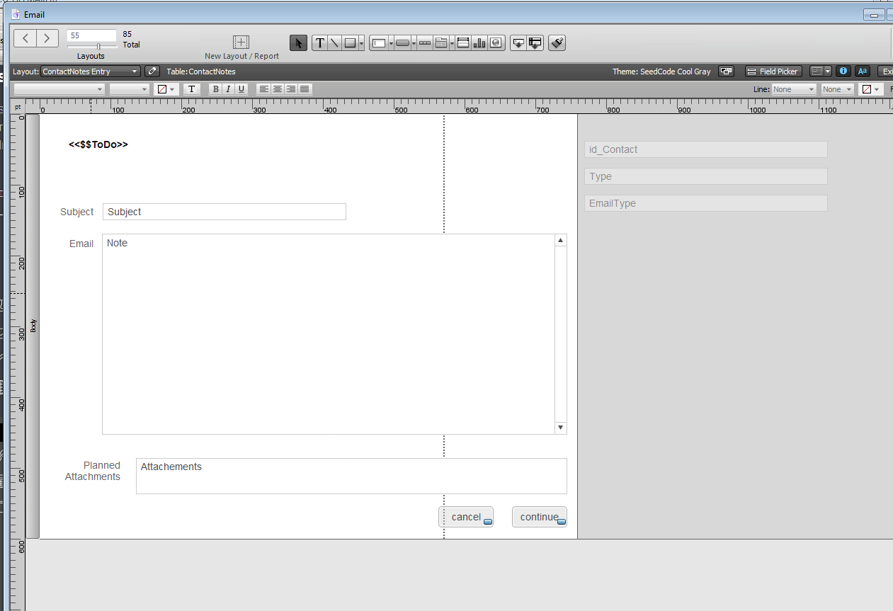

Attached a copy of the script (part 1) and my layout.
The "Go to Object" script fires right at the end after the last step "Exit Script" on my script part 1.
Actually I just noted, that almost every button in my Contacts layout seems to call automatically the Script "(Button) Contact" after the script attached to the button. (see screenshot debug)
I can't work out where this is coming from, but looks like this is what causes the issue.
I tried also to "Exit current Script" when assigning the script to the button.
What I am doing:
I find a set of records I want to email to.
I then check on the number of records and go back to the first record.
Then I create a new record in the Notes section and pre fill it (new layout).
Script Part 1 is finished and I get the error message.
Part 2 of the script (not included as attachment):
After I press continue, it creates an email in Outlook and an entry in the notes section to each individual contact record that was found in part 1.
I noted, that it does call a lot of other scripts just by moving between records and performing the find. If you have any tips on improving my script, I would be very happy to hear.

PostPosted: Mon Apr 24, 2017 10:57 am
Thanks for the additional info.
Most likely the reason the "Go To Object" script is being performed right after your script finishes or exits is that the On Timer script has already been created with "Call Go To Object" before your script was performed. Since the time hadn't elapsed before your script was called, the "Go To Object" waits until your script is finished, then it is performed.
