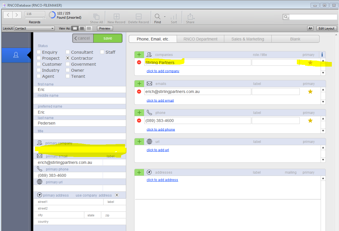

I have done some contact imports based on your video, but I am struggling with one part. I just can't get the company name into the primary company name field.
I can see the company in the contact record Edit screen and it is ticked as Primary, but it is not showing on the left side. (see screenshot)
Please can you help me here, how I can display the company name.

Thanks again for reaching out to us here. After taking another look at John's video describing the Contact import process, I remember that he does cover this particular step. If you play the video at around the 11 minute mark, John walks through the steps so that the Company ID and CompanyName are stored in the Contact record itself. This will cause the Company to appear in the Contact details sidebar.
I hope this helps! But please let me know if you still have any questions about getting the Company to appear on the Contact record, after reviewing that portion of John's video.

Thanks for the tip. I ended up deleting everything and started again.
I think at one stage I must have forgotten to choose the correct table and overwrote my Contact IDs with the Company IDs or vice versa, because both were the same in my import file. which was the reason why it didn't work, even though I had done all steps.
