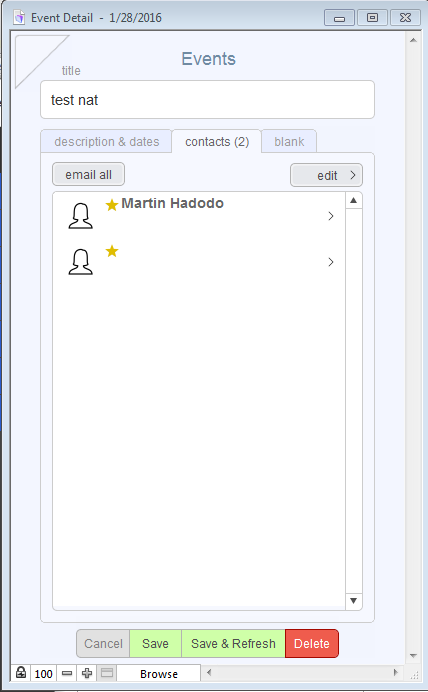

I just removed the name (Martin) and it cleared it, but the record (Martin) is still visible in the Contact Tab in Events Viewer. Q1: How can I remove it from there?

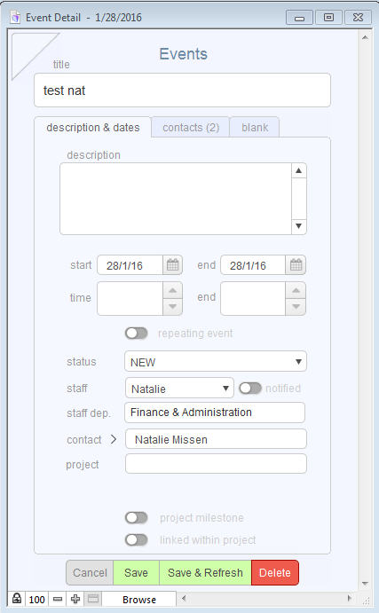

I then added a different Contact record (Natalie) to the Event, but the name (Natalie) is not showing in the Contact Tab, just an empty space. It does show on the Events Description & dates Tab.
Q2: How do I get it on the Contacts tab?
Events Contact Tab.PNG (19.76 KiB) Viewed 20806 times
events Details after change.PNG (28.16 KiB) Viewed 20806 times
PostPosted: Thu Jan 28, 2016 9:52 am
Thanks for reaching out on this. Events can have both one Primary contact and an unlimited number of linked Contacts (linked through the join table named EventsContacts).
Assigning a primary contact will also add that contact to the list on the Contacts tab, but deselecting or changing the primary contact will not cause that contact to be removed from the Contacts tab. To remove the contact from the Contacts tab, click the "edit" button on this tab, and click the red delete icon.
I hope this helps! For more info on event contacts, see the link below. If you have any other questions on this, let me know. http://www.seedcode.com/pmwiki/pmwiki.p ... tactEvents
Dan
