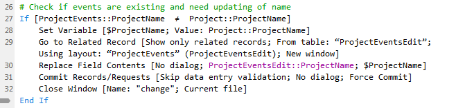

PostPosted: Mon Feb 08, 2016 6:27 pm
Hi Dan,
All good, I just added a couple of script steps to update the project name in existing events.
Attached a screenshot of what I did, in case somebody is interested.
update events.PNG (13.02 KiB) Viewed 40944 times
PostPosted: Tue Feb 09, 2016 11:35 am
This is great. Thanks so much for sharing!
