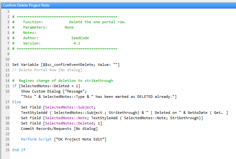

I changed the Delete function for the Notes from actual deletion of a record to a strike through function, so the text is still visible but crossed out.
The only problem I am facing now is, that I can't seem to get the buttons displaying correctly for the next action.
ie I am deleting a note with the button Delete and Confirm Deletion and it does it all and goes back to the Project View Panel, but when I then click ie New Note, the button shows the Cancel | Confirm Deletion instead of Cancel | Save | Delete.
I can't work out how to control the button display.
Attached a screen shot of my Deletion script modifications.
deletion script.PNG (24.49 KiB) Viewed 23737 times
PostPosted: Thu Jan 28, 2016 10:33 am
Cool modification! It looks like you've uncovered a little error in our "Confirm Delete Project Note" script. The first Set Variable step should have the variable name $$sc_confirmNoteDelete, not $$sc_confirmEventDelete. Making that correction should cause the buttons to display as expected after "deleting" a note.

PostPosted: Wed Feb 03, 2016 11:51 pm
Hi Dan,
Thanks for the update.
I have updated it and it works fine now.
