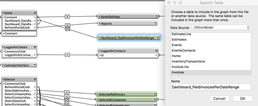

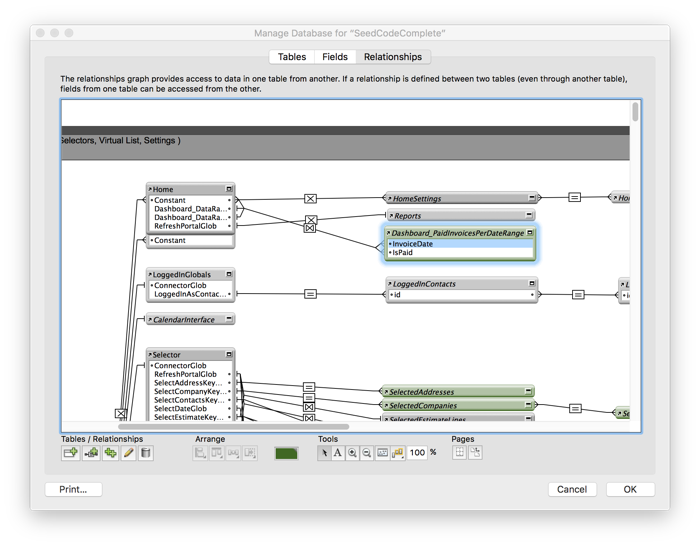

In this example we'll just do unpaid invoices. To get started I created new a new table occurrence of invoices in the SeedCode Complete file called "Dashboard_PaidInvoicesPerDateRange".
I then created a few new fields global in Home to use for the date ranges. It turns out I just needed "Dashboard_DataRangeStartGlob" and "Dashboard_DataRangeEndGlob". I'd set these on start up with the dates I'm interested in--say the last 30 days--but you could make a nice interface to let folks set all sorts or ranges into here including YearToDate and LastYearToDate. I also created two new global fields in Home to store the values: Dashboard_UnpaidInvoiceCount and Dashboard_UnpaidInvoiceAmount
I then wired up our new table occurrence to Home like this:
Once that's done--and you have values in your start and end date range globals, you can create a script that sets these two values like this. I'd set the values as part of start up as well or you could wait until someone clicks your "refresh" button on your dashboard:

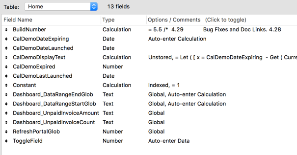

Hi John.

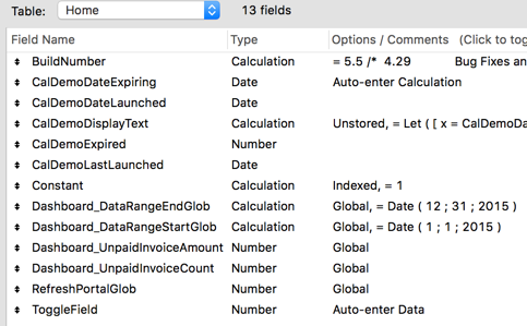

I followed your example faithfully I think. But my fresh script returns zero in the fields. What did I do wrong? Here's what I have:

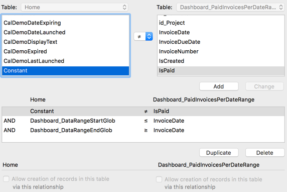

I added 4 global fields to the Home table. Dashboard_PaidInvoicesPerDateRange is tied to Invoices from the model file.
This is the relationship layout.
I added a calc field to Dashboard_DataRangeStartGlob and Dashboard_DataRangeEndGlob with start and end date. Here's my calc: Date ( 1 ; 1 ; 2015 ) Date ( 12 ; 31 ; 2015 ) one per glob field.
I then added Dashboard_UnpaidInvoiceAmount and Dashboard_UnpaidInvoiceCount as fields on the Home layout. The refresh script returns zero when I run it.
I feel that I am so close. Please help.
Thanks. Ken
PostPosted: Wed Jan 20, 2016 7:51 pm
Those date range globals need to be of the type "date", not text. (Thanks for the screenshot!)
Going further, I think you'll have better luck with them if they are either calculation fields set to global storage (and returning the type "date") or global date fields that you set with your own values on startup: global auto-enter calcs can be hard to reason about and refresh.
I also think the amount and count globals you added for your result might be better as number so you can more easily format at least the one of them as currency.
Aside from that, it's gonna be cool!

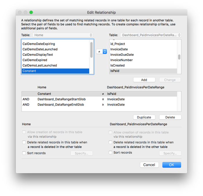

Here's the date range layout:
Relationship between Home and Invoice table from Model:
PostPosted: Thu Jan 21, 2016 7:53 am
Hmmmm. Well it could be that you have un paid invoice records from 2015 (your relationship name says "paid" but your relationship where "constant ≠ paid" is looking for unpaid).
It could also be that those two date calcs are still not returning the type "date". The way I troubleshoot this stuff is to create a portal from Dashboard_PaidInvoicesPerDateRange on the home layout and see if invoices show up in there. Then you can tweak the relationship until then *right* records show up in there.

PostPosted: Thu Jan 21, 2016 10:13 am
Got it!
My start date range global was equal or less than but should have been equal or greater than. Same for end date range global.

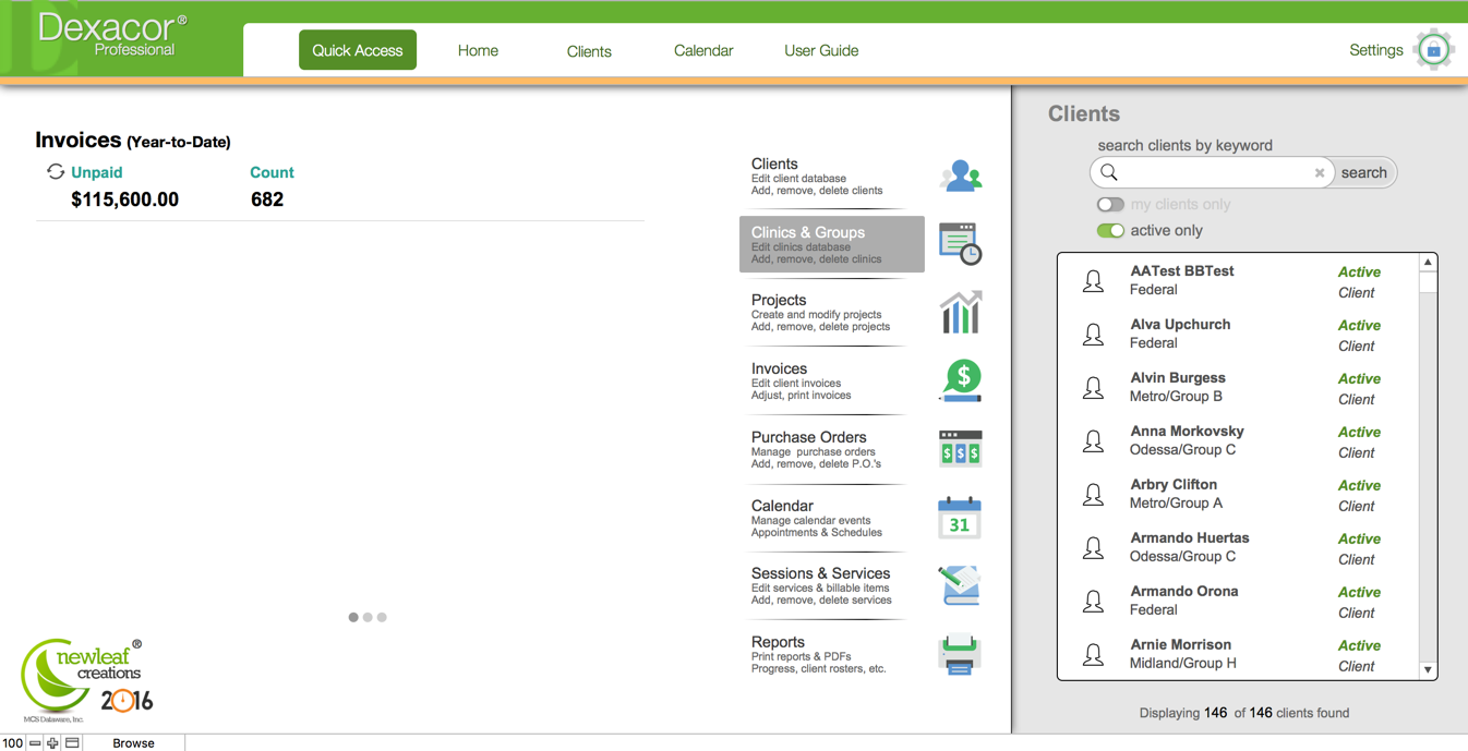

PostPosted: Thu Jan 21, 2016 2:37 pm
My first Dashboard item. Only 9 or 10 more to go.
Many, many thanks John for helping me get this going. I learned a great deal from this experience. Mostly confidence that I can navigate this solution and pull out the data as needed.
Only a couple of issues left to resolve. How do I calculate YTD current year and YTD last year?
Will show off the finished dashboard soon.
Take care, Ken
PostPosted: Thu Jan 21, 2016 8:39 pm
Looking good! Can't wait to see the finished dashboard; I'd love to post this to our blog so other folks can see what you've done here. That work for you?
Oh, so YTD for last year is done by changing the values in those two global date range fields. I know you made yours as calcs but this is one reason they're better as global date fields: your script can set them to the current YTD and update all the YTD values, then it can set them to Last YTD and update last year's values.
Just be careful if you're also using these globals for a GoToRelatedRecord to jump to the YTD or LYTD invoices: you'll want your GTRR script to set the date range again before using the relationship as you won't be sure if you left it on YTD or LYTD.
And since they are globals you can make a whole bunch of buttons to set them to any ranges you want to compare: this month vs last month, this qtr vs last, etc.
