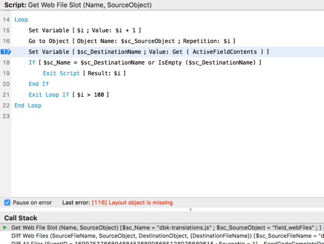

Oops! I did something wrong when adding the DB calendar to SC but can't figure it out.
Please help.
Selecting "Open Event in Calendar" from contact record does not open the event in the calendar. It goes right back to the contact's event display layout.
Using script debugger I get the following error "[116] Layout object is missing". Any idea what I did wrong here?
Thanks.
Ken

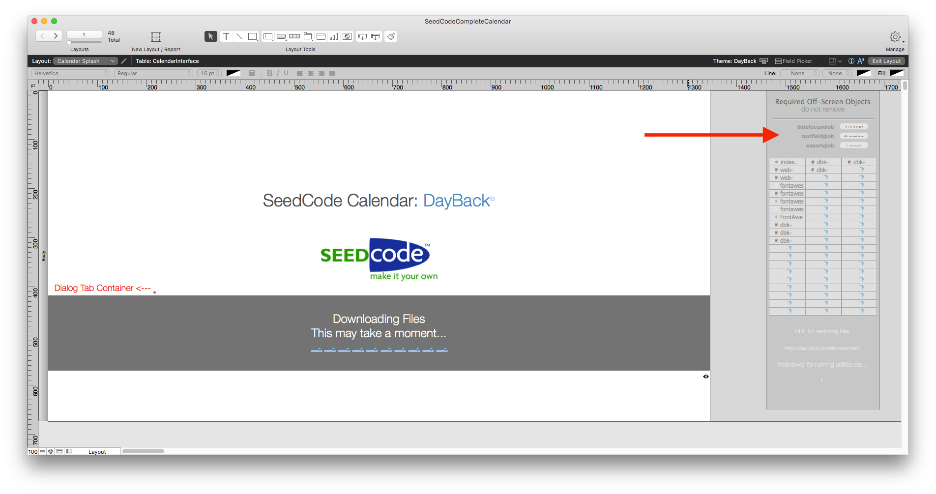

Sounds like you may be missing some of the off-screen objects in the calendar. If you open the original DayBack calendar file you're copying from you'll find that four layouts have some off-screen objects.
splash (shown below)
calendar (same idea, but different objects)
web viewer: under the hood (different objects)
edit text file (also different objects)
If those off-screen objects are missing from your layouts, I'd copy them originals from DayBack and paste them in.
If you're using an unmodified copy of DayBack or those objects are there, then I think you may have an issue with your scripts. Make sure the script "OPen Contact Event in Calendar" looks exactly like the one in the reference copy of Complete you're working from.
Let me know what you see; I'm sure we can find the issue.
