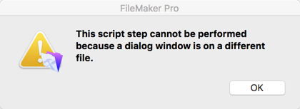

I ran across a problem adding a contact to a DayBack calendar event. I thought it was something to do with the DB integration into SC 4.50 so I tried the same procedure with a untouched copy of SC/DB I received earlier. The same error occurs in that file as well.

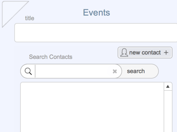

The error occurs when searching for a contact to add to a calendar event.
This is the error message that pops up when I hit the search button. Can't figure out what dialog box this error is referring to. Script debug didn't show any problems with a dialog box.
Any help would be appreciated.
Thanks. Ken

Hi Ken,
You are so right. Thanks for bringing this to our attention. In the script “Draw New Event Window”, modify the Advanced Style options of the "New Window" script step, so that the window is a Floating Document rather than Modal window. This change should let those Contact searches work as expected. Let me know if you have any other questions on this.
Dan
Posts: 72
PostPosted: Mon Jan 11, 2016 8:30 pm
Hi Dan.
Thanks for the quick fix. That was easy to fix. Working great now.
Thanks a bunch.
Ken
