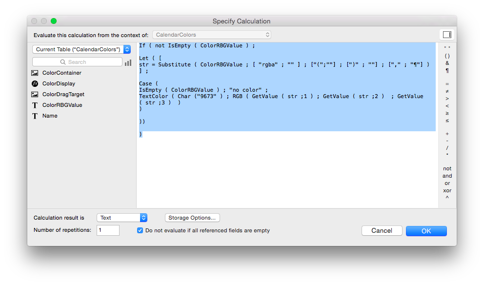

7. From the v4.50 version of the SeedCodeModel file CalendarColors table, copy the Contents of the calculation field ColorDisplay and paste it over the contents of the same calculation field in your current SeedCodeModel Calendar Colors table.
Paste Contents.png (99.29 KiB) Viewed 16206 times

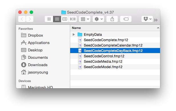

9. Add the SeedCodeCompleteDayBack.fmp12 file to your SeedCode Complete folder.

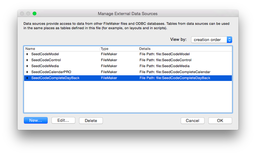

10. Add SeedCodeCompleteDayBack as an External Data Source as shown. This control is accessed through File / Manage / External Data Sources
