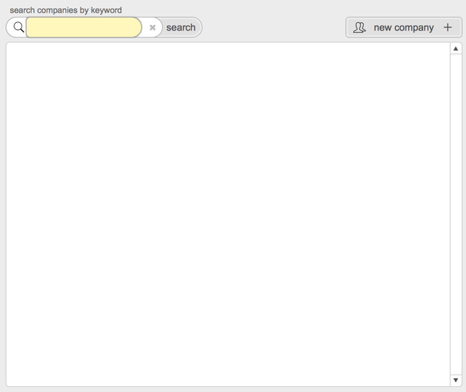

What is the best way to show a complete list of companies from the primary company association panel when in Contact edit mode without having to enter search criteria?
There is a "select company from selector" script on the portal for companies. Can this be modified to show all companies?
Here's the screen I'm working with:

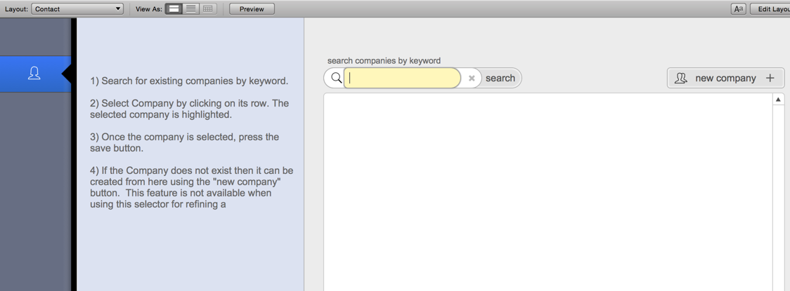

PostPosted: Fri May 22, 2015 5:14 am
Sorry, here's better pic. When editing a contact's info and selecting either the primary company or additional company I would like to have a list of companies auto-display on the selection layout instead of having to search initially.
I am trying to backtrack the code but can't quite figure out the best way to approach this without messing up the search filter.
I hope this makes sense.

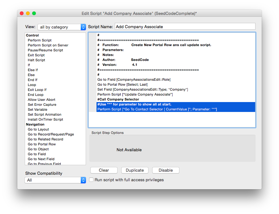

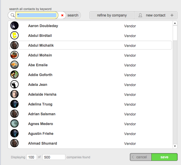

PostPosted: Fri May 22, 2015 10:01 am
Hi Ken,

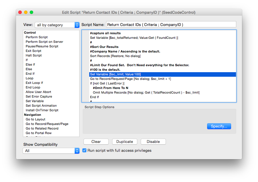

The easiest thing to do would be to pass a "*" (asterisk) as the current value parameter. This will do a wildcard search and return find everybody. The find that's done in the control file is set to only return a 100 results, so if you want more returned by default, you'll need to change the limit variable in the control file.

Posts: 72
PostPosted: Fri May 22, 2015 7:40 pm

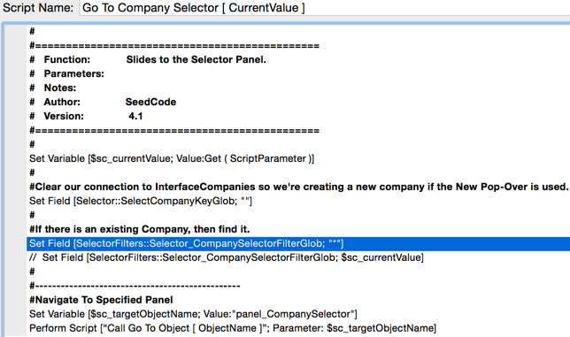

Not sure why but using the wildcard in the "Add Company Associate" did not work. Using debug I found that the script used was "Add Secondary Associate" but adding the wildcard there didn't work either.
Using debug I found that script "Go to company" was called and following your example I added the wildcard as shown below and it worked.

PostPosted: Mon May 25, 2015 8:15 am
Hi Ken,
Thanks so much! I'm not sure why passing the "*" as a parameter didn't work as opposed to setting it as a literal, but I'll add this as a bug to run through.
