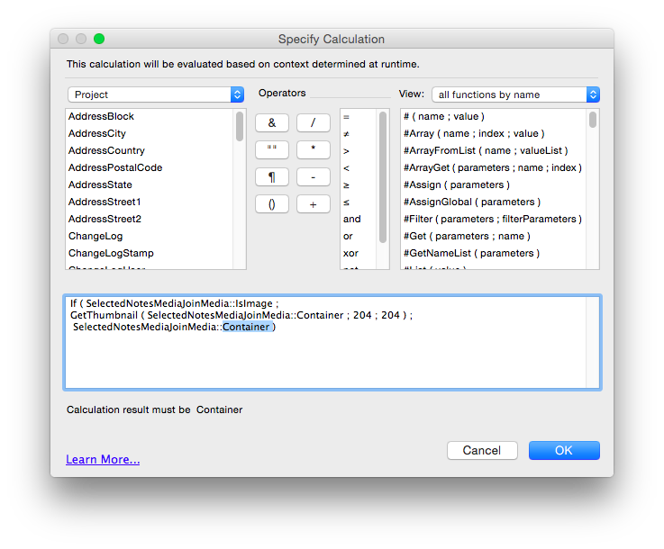

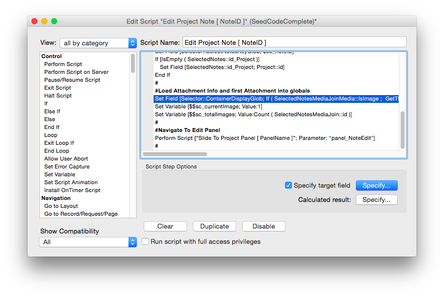

Hi Caps,
Thanks so much! Yes we have a bug there on the Project Note attachment. In the Edit Project Note [ NoteID ] script, correct the calculation in the specified script step as shown here:
Screen Shot 2015-02-11 at 10.08.55 AM.png (138.46 KiB) Viewed 11023 times
Screen Shot 2015-02-11 at 10.09.15 AM.png (104.19 KiB) Viewed 11023 times
