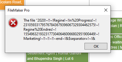

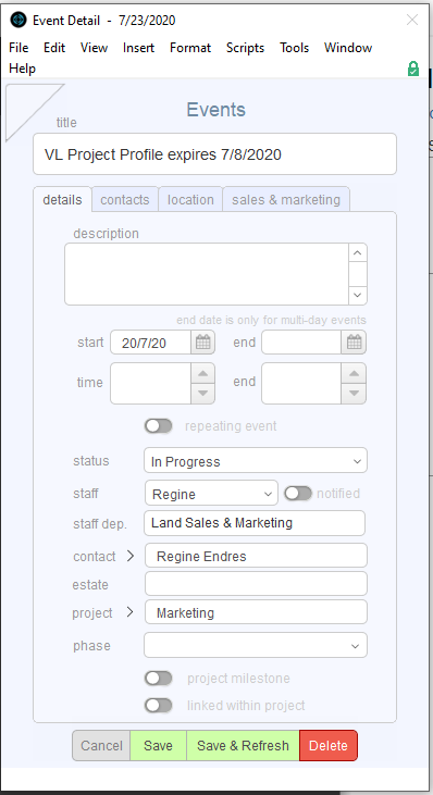

Hi Guys,
I noted, that moving an event in the calendar by drag and drop produces an error (see screenshot attached).
Since I am using SeedCode Complete I am posting it here.
I have also attached a screenshot of the event. There is nothing special about it.
After I have click OK for the error it looks like it worked, but when I go out of the calendar and come back, the event is back on the original date before the move.
I haven't seen this before. Any idea what is going on here?

PostPosted: Thu Jul 23, 2020 6:44 am
Thanks for the screen-shot. It looks like you've upgraded to FileMaker 19. There were some changes with the web viewer in FileMaker 19 that introduced this issue in DayBack Classic, so there are some required updates for it to continue working in FileMaker 19.
Getting your calendar up to the latest, build 10.60, will fix this error and get you up and running in FileMaker 19. There are some required script updates that you'll need to apply after running the in-app updates, which you can find here: https://www.seedcode.com/pmwiki/index.p ... ionHistory
I hope that helps!
