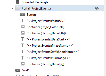

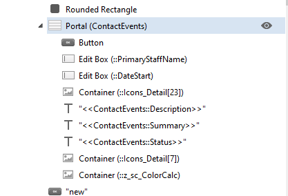

I am having an issue with the update:
My Portals ContactEvents and ProjectEvents look different. They don't have a Group?! see attached
Also I have multiple Portals for Ascending and Descending, so I assume they would all need to be updated, correct?
Please can you advise what I am doing wrong here?
PostPosted: Tue Oct 01, 2019 7:50 am
Thanks for the screen-shots. Since you've made customizations to your layouts, the organization of the objects might not look the same as a stock copy of Complete.
It looks like you already have container fields pointing to the "z_sc_ColorCalc" field. So as long as the color icons are showing correctly, there's no need for you to change anything.

Thanks KC,
I must have done the customization right at the beginning. Couldn't remember that!
