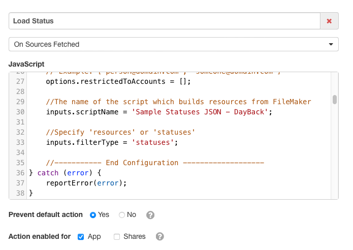

Posts: 109
PostPosted: Fri Jul 15, 2022 7:56 am
I set it up like the picture here. And 2 lines were changed (30 and 33)
I also ran the script and I can see the correct data going into $json, etc. but nothing changes on the sidebar.
Screen Shot 2022-07-15 at 11.50.11 AM.png (65.36 KiB) Viewed 108900 times
PostPosted: Fri Jul 15, 2022 9:47 am
Hi Jim,
It looks like the custom action is set to the wrong trigger. Based on your screenshot it is set to "On Sources Fetched" currently. That will need to be changed to "On Statuses Fetched". This is the setting just below "Load Status" in your screenshot. Please let us know if that doesn't resolve your issue.
Tanner

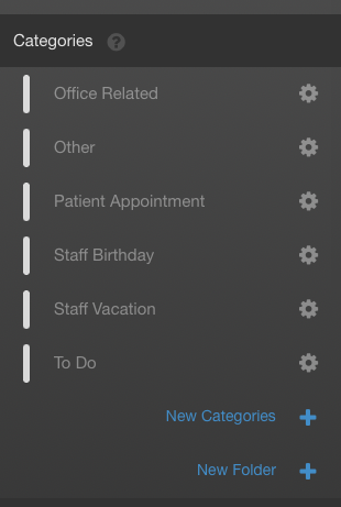

One last thing and I'll close this thread: is it possible to hide the color indicator to the left of the Status name?
Screen Shot 2022-07-15 at 2.47.16 PM.png (59.92 KiB) Viewed 108889 times
PostPosted: Fri Jul 15, 2022 2:21 pm
Yes, you could accomplish that with some custom CSS...
.status-list .list-selector .calendarColor {
    display: none;
In DayBack custom CSS can be added by navigating to the settings tab in the sidebar, then click "Administrator Settings", then select the "Colors, Fonts & CSS" section to add the CSS. Make sure to click save after you have added the CSS.
That should do the trick.
