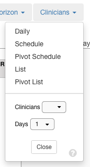

I have relabeled the Resources to "Clinicians". However I notice that the Columns field will not retain a number. I can put one in and it will work just fine, but if I check the dropdown again the field is blank. The variable for $$sc_ResourceColumns is set to 3 in the Load Calendar Settings script, and I can see the variable is present in the Data Viewer. This just started happening in the last few days.

Hi Jim,
Are the resources loading correctly? Check the data viewer for the Resource Names and Resource Short Names and make sure they're both getting populated with the same number of values. That's the only thing I can think of off the top of my head. If that's not, send us a note at support@seedcode.com and we'll make arrangements to take a quick look at the file and see if we can tell what's going on.

Hi Jason, Thanks for responding. This issue has cleared up this morning after I set $$sc_ClearUserSettings back to "true" and cleared the caches in safari. I'll watch this over time to see if that was the issue. :D
