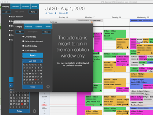

One other thing (may or may not relate but happened at the same time) is that I have several scripts that call a new window on top of the calendar with a specified layout (very simple layout with just fields on it. It seems that the Calendar layout just appears in this window (for some reason) and the rest of the script stops working. This is under FM18 and Mojave. I've been trying to reproduce this but since I have nothing here with Mojave on it, it's a bit of a challenge. I've attached a picture so you can see what I mean.
Screen Shot 2020-07-30 at 2.50.41 PM.png (213 KiB) Viewed 87262 times

Thank you for the details. With FileMaker 18 you can specify the layout the new window should land on, by default, it will be the current layout that will attempt to launch DayBack's opening routine, so specifying the specific layout in the new window script step should fix that issue.
You can get some hinky behavior with no record or changing records with the web viewer, so preventing deletion and creation of that interface record is a good idea.

I did set the "new window" to have a specific layout, but it seems to be ignored. I will let you know if I can work out what's going on with my client. They are on Mojave apparently but I don't see how that would be an issue with FM18.
PostPosted: Fri Jul 31, 2020 6:37 am
Hmm. I haven't seen that fail before, maybe some kind of trigger (on window open) that's redirecting it back to the DayBack layout? The debugger should show that. As I mentioned in the other thread, we may have to have a look at the file directly to see if we can tell what's going on. Drop a note to support@seedcode.com and KC will make arrangements.
