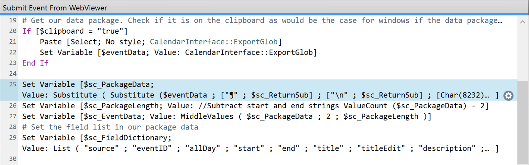

Next, you will need to make a change to the [b]"Submit Event From WebViewer"[/b] script.
Please copy the script step shown in the screenshot below from the newly downloaded file and replace the correlating script step in the same script in your file.
[attachment=0]SubmitEvent.png[/attachment]
