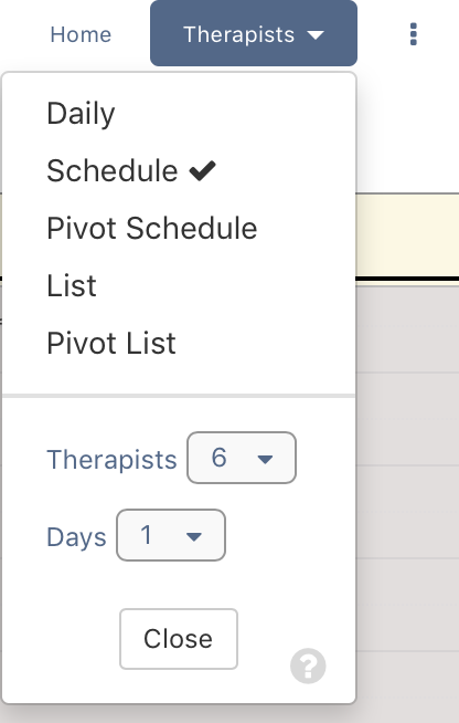

We recently upgraded all our Macs to FileMaker Pro 16 in order to resolve an esoteric portal bug. Since then, DayBack has been inconsistently loading the wrong number of resource columns, even though the $$sc_ResourceColumns global is set correctly.
The background is that we have 1 DayBack file with 4 sources. When users enter DayBack, they select a location and based on that, the correct Resource list is loaded, the appropriate # of ResourceColumns are set and DayBack loads in ResourceSchedVert mode, 1 day only.
The problem is that, since upgrading to FMP16, when users switch to a different location, even though $$sc_ResourceColumns loads the correct # of columns, they only see the # from before they switched, and the # of resources in the Resources pulldown menu shows the old number.
In the attached image, this location has 23 columns, and $$sc_ResourceColumns value is indeed 23, but '6' shows up in the pulldown menu, and indeed only 6 columns are shown - that was the #of columns from before they switched. Users either have to page through 4 pages of resources, or manually-select '23'.

Thanks for the screenshot, Eugene! I like that mod of changing the # of resources based on location; nice one.
I'm not completely sure what's going on with the number of resources lagging behind your change; can you let me know which version of DayBack you're on?

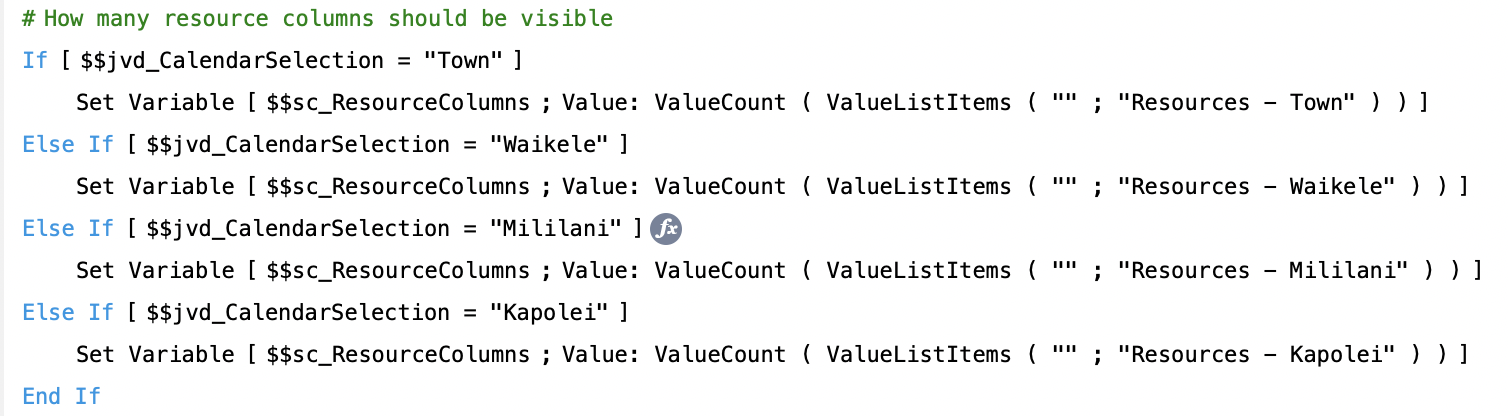

If you're curious, this is how we interactively determine the column count:
Screen Shot 2019-12-01 at 6.26.54 AM.png (236.34 KiB) Viewed 34846 times
...the value lists represent the therapists who are flagged as 'on the calendar' in their respective locations. This way, they can add or remove therapists from the schedule without having to reconfigure the calendar. the '$$jvd_CalendarSelection' global variable is what we set when they enter the calendar, or switch to a different location.

As far as the FMP Protocol error goes, you'll need to either manually assign the FMP URL protocol to FileMaker 18 on your machine, or update your calendar to 10.55 and make sure you've applied all of the required script updates to take advantage of the version-specific FMP URL protocol feature added in FileMaker 18. One important thing noted in the 10.50 script updates is that you need to use FileMaker 17+ to copy over the "Set Temp Path Folder" script or it will break the calendar for FileMaker 18+. This is because the "Create folders" option of the "Export Field Contents" script step doesn't exist in earlier versions of FileMaker. To see if this is the issue with FMP18 and fix it, open the "Set Temp Path Folder" script in FileMaker 18 and verify that the "Create folders" option on line 18 is toggled to "On".
As far as the resource columns refreshing goes, changing the "$$sc_ResourceColumns" variable only has an effect when the calendar is first loaded using the "Upon Opening" script. To change the resource columns after the calendar is loaded, you'll need to perform the "Refresh Calendar" script and pass the parameter "sc_resourceColumns" as the number of columns you'd like to change to. You can see all the optional parameters and an example of how to refresh the calendar this way in our docs here: https://www.seedcode.com/pmwiki/index.p ... shCalendar
