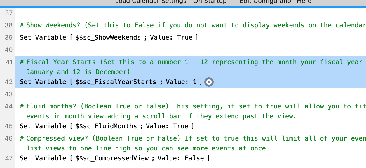

Next you will need to make a few changes to the "Load Calendar Settings - On Startup --- Edit Configuration Here ---" script.
Please copy the script step shown in the screenshot below from the newly downloaded file and paste them in the same script in your file.
Fiscal Year Starts.png (143.01 KiB) Viewed 58036 times

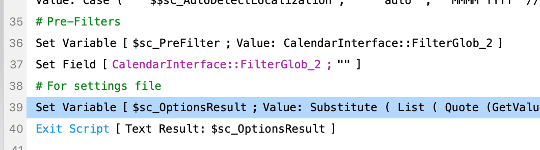

Next you will need to update the script "Webviewer Settings". In the new downloaded file open the script and find the script step as shown below.
WebViewer Settings.png (69.9 KiB) Viewed 58036 times

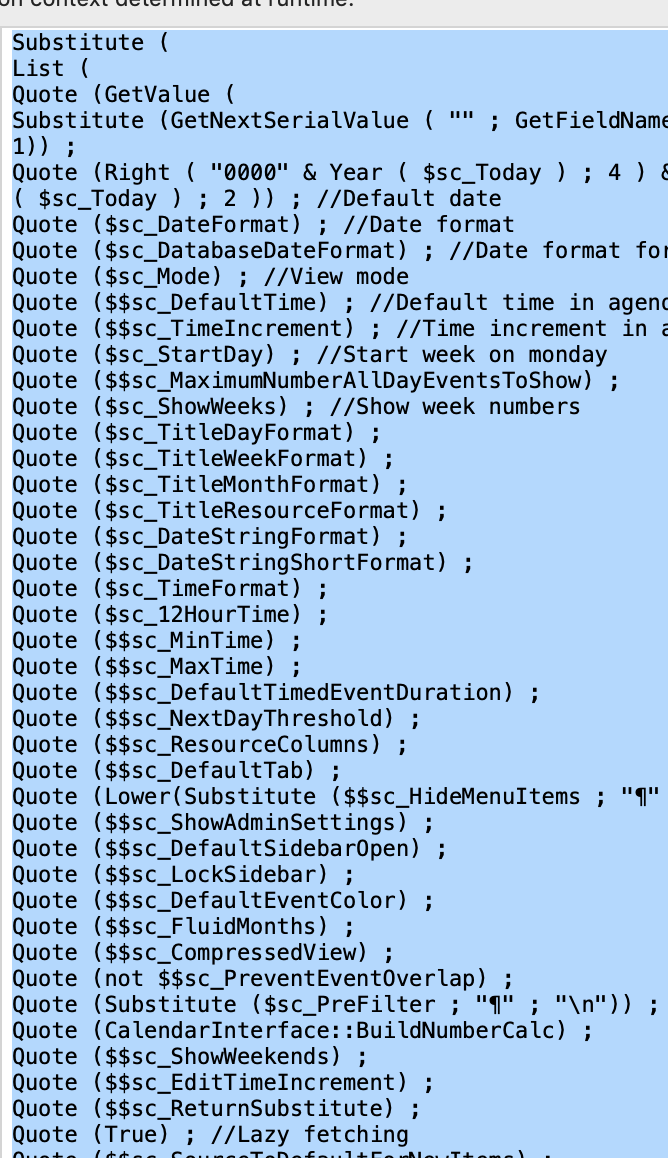

Open the set variable $sc_OptionsResult script step as shown in the image and copy the contents of everything in the calculation for the set variable script step. Then in your file replace the contents of that same script step in your file as shown below.
Options Result.png (309.69 KiB) Viewed 58035 times

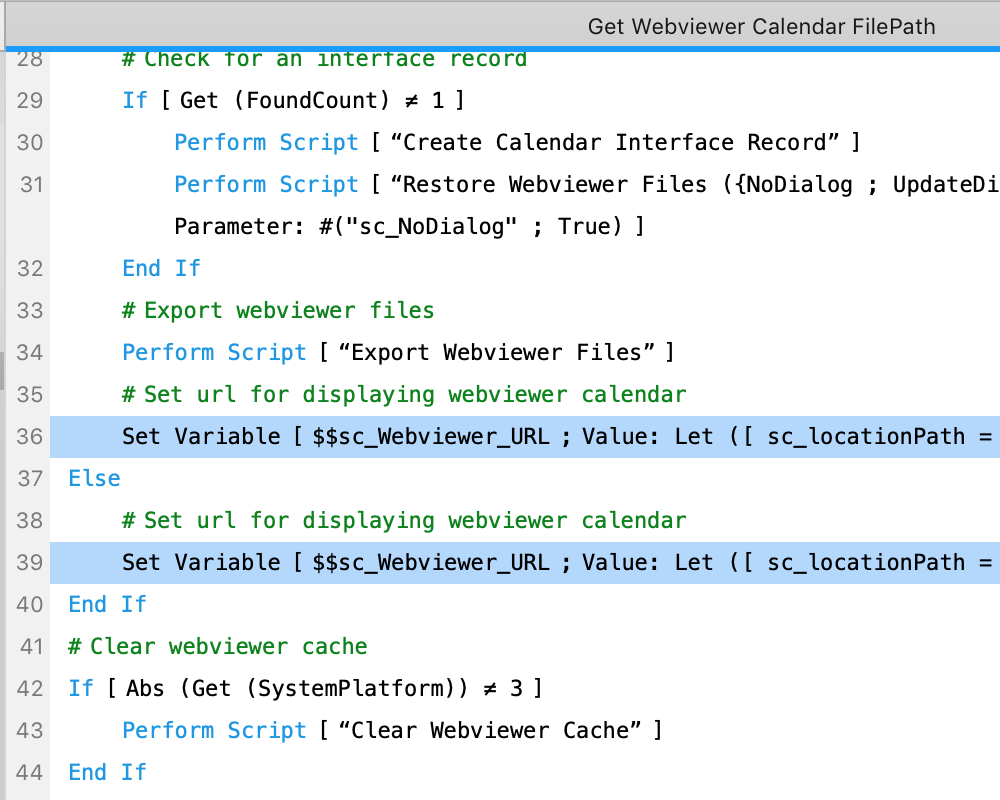

Improving support for FileMaker 18
The "Get Webviewer Calendar FilePath" script contains two Set Variable script steps that need to be updated. Both steps set the $$sc_Webviewer_URL variable and are highlighted in the screenshot below.
In script step #36, double click the Set Variable step to open the "Set Variable" Options window.
Click "Specify..." next to the Value field to open its "Specify Calculation" window.
Find the line in the calculation that begins "sc_appVersion" and replace that line with the content below:
sc_appVersion = Left ( Floor ( GetAsNumber ( Get ( ApplicationVersion ) ) ) ; 2 ) ;
Then repeat the same process for script step #39 and save the script changes when done.

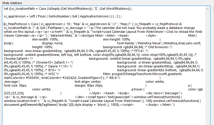

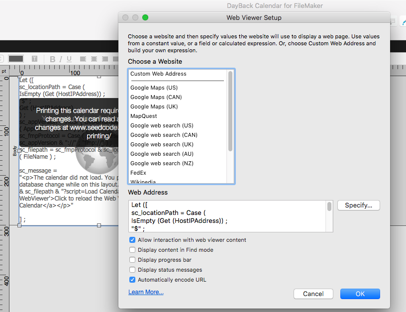

The "Web Address" calculation in the calendar web viewer object also needs to be updated.
In your DayBack file, navigate to your "Calendar" layout (you may have renamed it).
Enter Layout Mode.
Double click the Web Viewer object to open the "Web Viewer Setup" dialog as in the screenshot below
Click "Specify..." next to the Web Address field to open its Specify Calculation window.

PostPosted: Thu Sep 05, 2019 8:51 am
Per the first screenshot in the original post, I am not finding a comment line in the linked, current copy of DayBack that starts with "Fiscal Year Starts" as shown on lines 40-41 or anywhere else in the referenced script.
There's also a comment above the highlighted section mentioning weekends and I can't find that one in the linked copy of DayBack either!
Help!
PostPosted: Thu Sep 05, 2019 9:35 am
Hi rbparker,
The link to download DayBack that is in our posts always downloads the latest copy of DayBack. Since the post was being drafted when you first found it and clicked on the link, the version of DayBack that was downloaded was build 10.54. This means that it won't have these new script additions for 10.55 in it.
I've just verified that the latest build of DayBack contains the lines as shown in the screen-shots, so you'll just need to use the link again to download the latest build and follow the steps to apply the updates: https://www.seedcode.com/?smd_process_d ... d_id=10452

All the steps listed under "Improving support for FileMaker 18" are already like this? What am I missing?
PostPosted: Tue Oct 01, 2019 7:55 am
Regine,
We added the "Left ( " function to the calculation to limit the result to the first two characters of the version number. This was to fix an issue with files where a comma is used as a decimal point returning a 4 digit number.
The calculation is already there, but you'll want to update all instances of it to account for this.

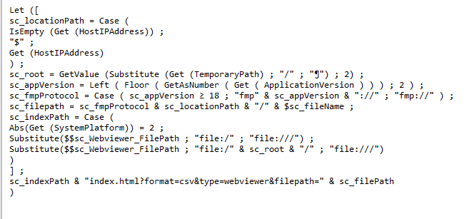

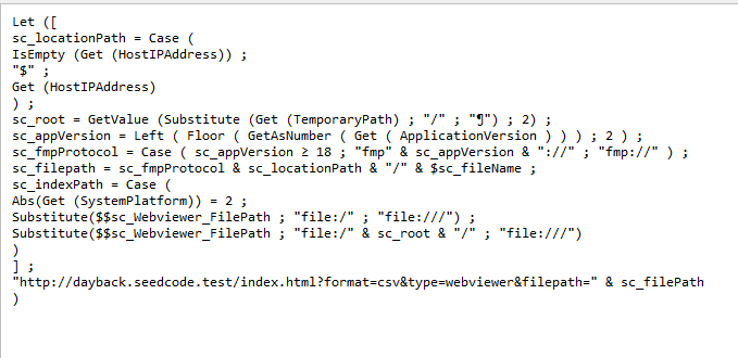

PostPosted: Tue Oct 08, 2019 9:32 pm
Hi KC,
But both script steps and the webviewer are already having the variable set exactly like the description with the Left function.
Attached screenshots of the unmodified script and webviewer. So I am wondering if there is anything else that needs to be changed?
script step 39.PNG (16.75 KiB) Viewed 57522 times
script step 36.PNG (16.15 KiB) Viewed 57522 times

PostPosted: Wed Oct 09, 2019 11:01 am
It looks like you've already completed all the changes you need in your web viewer and script steps, and you should be up to date for this version of DayBack!
