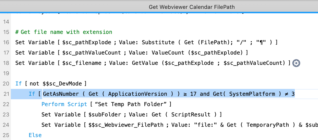

Fixing an issue related to FileMaker Go
The "Get Webviewer Calendar FilePath" script contains a "If Statement" script step that should be on line 21. This If Statement needs to be updated so that it excludes FileMaker Go.
Please change the contents of this if statement to the content below:
GetAsNumber ( Get ( ApplicationVersion ) ) ≥ 17 and Get( SystemPlatform ) ≠ 3
This should match the screenshot below:
FMGo Fix.png (123.2 KiB) Viewed 14875 times
Save the script changes once they have been made.
