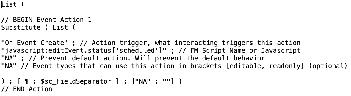

PostPosted: Sat Apr 18, 2020 7:20 am
I'm pretty sure I got the syntax wrong in Line 7 of the attached example. I looked all over the documentation and couldn't find it. Suggestions?

PostPosted: Mon Apr 20, 2020 6:51 am
Hi Eugene,
If you're looking to set the Status field to the literal value of "scheduled" when creating events, then your action should look like this:
"javascript:editEvent.status = 'scheduled';"
Using the square brackets like '[[schedule]]' is used for referring to another FileMaker field's value in a custom action. In an On Event Create action, the record hasn't been created yet, so the value of any fields referenced would be empty.

PostPosted: Tue May 12, 2020 3:15 am
KC,
Thanks for the correction. I finally had a chance to try it out, but it didn't work. The status field remains empty when a new event is created. Thoughts?
Eugene
PostPosted: Tue May 12, 2020 7:14 am
Hi Eugene,
I'm able to get this working in a stock copy of DayBack, so here are a couple of things to check.
1. Make sure you've added this as an "On Event Create" action under the "$$sc_EventActions[$sc_SourceNumber]" variable in the "Load Source Settings at Startup..." script. The $$sc_CustomActions variable is for custom button actions which are triggered by the user pressing a button.
2. Make sure you've added this event action to the correct source. There is a section in the script for each source, so just verify you've added the action to the source you're creating events for in the calendar.
Here's the exact code that I've put in the beginning of my $$sc_EventActions variable. You should be able to copy and paste this into your $$sc_EventActions variable for the action to take effect.
// BEGIN Event Action 1
Substitute ( List (
"On Event Create" ; // Action trigger, what interacting triggers this action
"javascript:editEvent.status = 'scheduled';" ; // FM Script Name or Javascript
"NA" ; // Prevent default action. Will prevent the default behavior
"NA" // Event types that can use this action in brackets [editable, readonly] (optional)
) ; [ ¶ ; $sc_FieldSeparator ] ; ["NA" ; ""] )
// END Action
