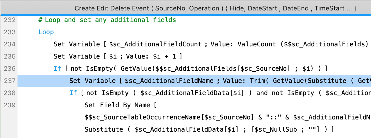

In your file edit the script "Create Edit Delete Event ( SourceNo, Operation ) { Hide, DateStart , DateEnd , TimeStart ... }". Scroll toward the bottom and find "Set Variable" script step for "$sc_AdditionalFieldName" as shown in the image below. Edit the set variable step.
Edit Additional Fields

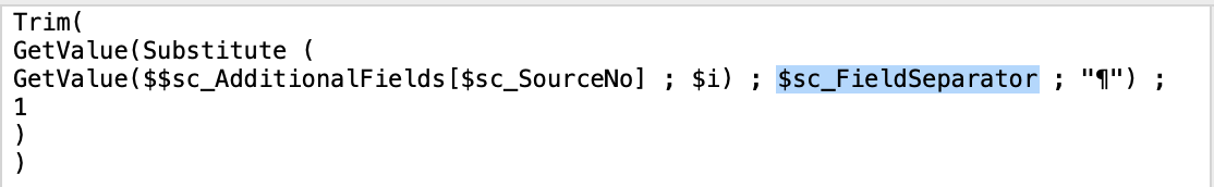

Now just as before replace the comma substitution with $sc_FieldSeparator. Make sure to save your changes to the script when done. Please Note: this might have already been done in your file. There were two DayBack releases that did not include this script change. If your file already looks like the screenshot below you are good to go.
Substitute Field Separator
