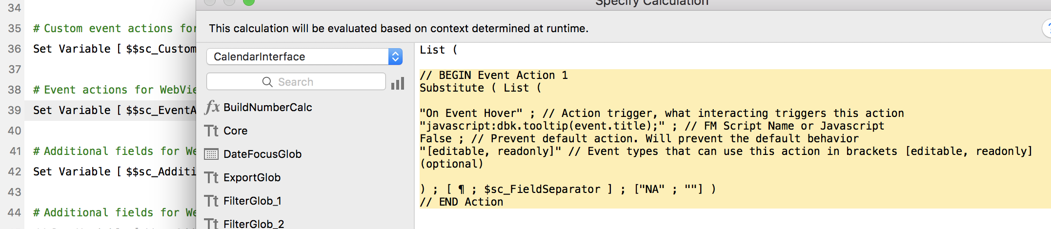

Thank you for sending over the file. We just need to add the Event Actions to your "Load Source Settings at Startup --- Describe Your Sources Here ---" script. We have some documentation here: https://www.seedcode.com/pmwiki/index.p ... entActions
Please see the below screenshot for an example of the changes you need to make. You make these changes on line #39 and line #84.
Screen Shot 2018-12-19 at 13.06.12.png (234.35 KiB) Viewed 1050617 times
Let us know if that helps.
Best wishes,
Ana

Boy I feel so stupid !!
I typed exactly like the picture in the link you gave me... the only thing I didn't get was the last line of code
"[editable]" ... my calendar is readonly that is why it was not showing up... it was editable then I switch it back to readonly because of the status conflic that I need to fix when I was moving an event in the calendar... that is why it was working before and it stop working after !!

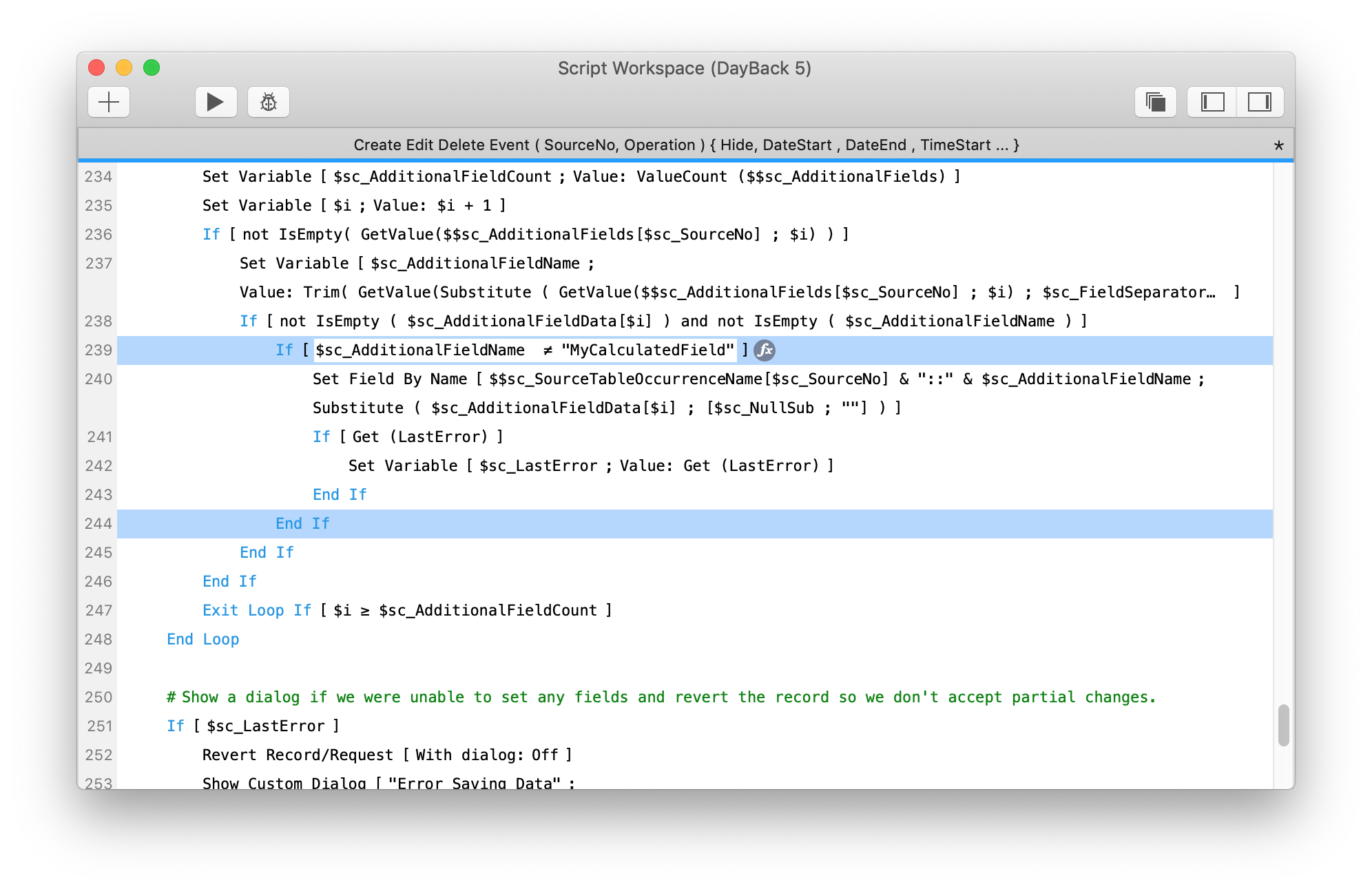

As John mentioned, you won't be able to reference a FileMaker field directly in an event action unless it is an additional field (or one of the built-in fields like summary, description, etc.). The action is saved to that calendar source as a template, based on the context of the event in the calendar (not the actual FileMaker record). So the event actions need to reference only properties of the event object.
So, you'll first need to setup your "A_CR0107" field as an additional field on that calendar source: https://www.seedcode.com/pmwiki/index.p ... onalFields
Only when it is set up as an additional field will that field's value be a property of the event object, and can then be referenced in an event action.
On your second note, the issue you're seeing is when trying to save changes back to a record. Since the field is calculated, you'll see a 201 error because FileMaker can't save back to a calculated field. To account for this on an additional field, you can add an If statement to your "Create Edit Delete Event..." script that prevents the script from trying to write back to that additional field. As shown in this screenshot
Additional Calculated Field
If you instead want to use the summary field, you would need to wrap the section commented "#Summary" in the same script in an If statement to prevent it from trying to save back to your calculated field when $sc_SourceNo equals the source you're applying the tooltip to.
