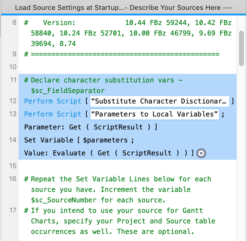

Next you will need to make a few changes to the "Load Source Settings at Startup --- Describe Your Sources Here ---" script.
Please copy the 3 script steps shown in the screenshot below from the newly downloaded file and paste them in the same script in your file.
substitution dictionary
Screen Shot 2018-12-12 at 11.54.06 PM.png (154.3 KiB) Viewed 15526 times

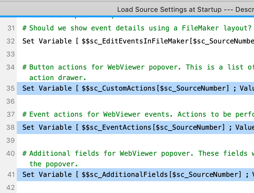

Now in your file in the same script (Load Source Settings at Startup) you will need to update all instances where a return character is substituted for a comma. In this case we need to change the substitution to $sc_FieldSeparator. Please locate the three set variable steps as shown in the image below.
load sources steps
Screen Shot 2018-12-14 at 2.00.28 PM.png (118.72 KiB) Viewed 15526 times

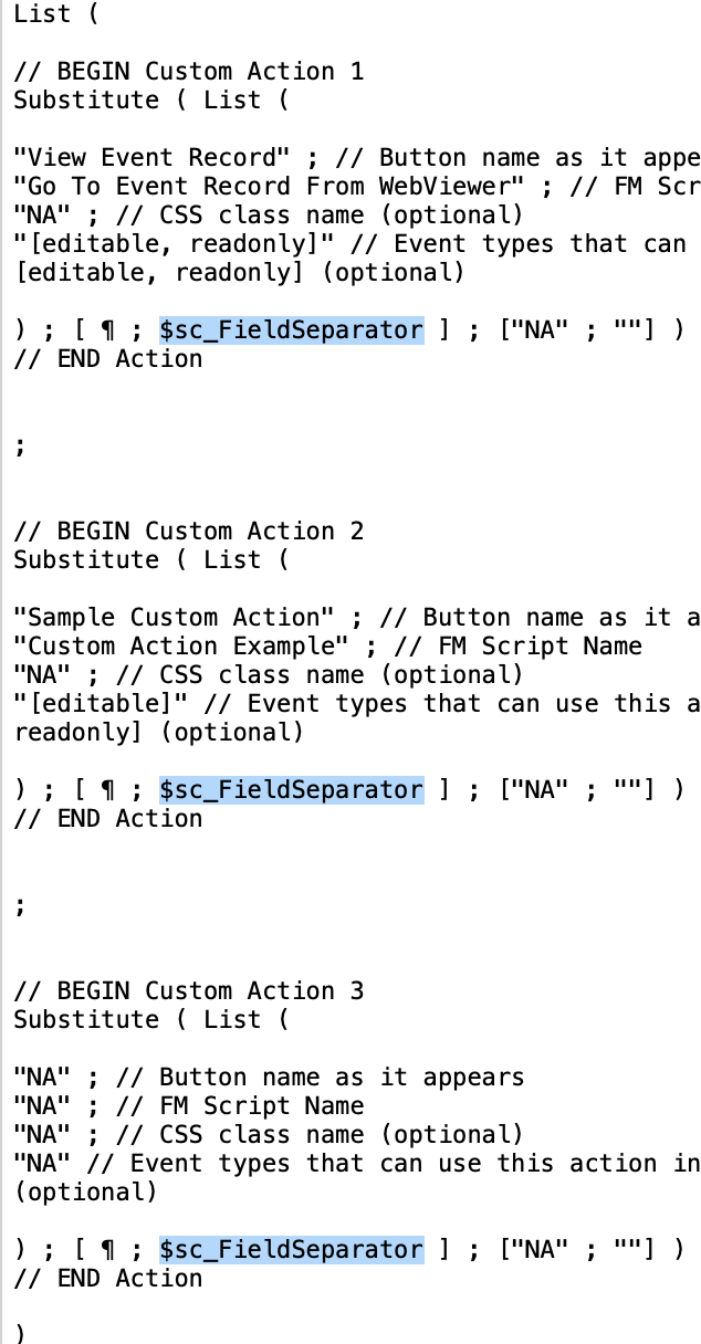

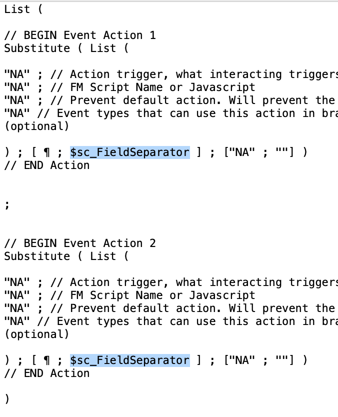

Now for each set variable step please edit each substitution in the calculation replacing the comma substitution with $sc_FieldSeparator as shown in the images below.
$$sc_CustomActions
button actions
Screen Shot 2018-12-12 at 11.56.20 PM.png (154.06 KiB) Viewed 15526 times
$$sc_EventActions
event actions
Screen Shot 2018-12-12 at 11.57.14 PM.png (104.96 KiB) Viewed 15526 times

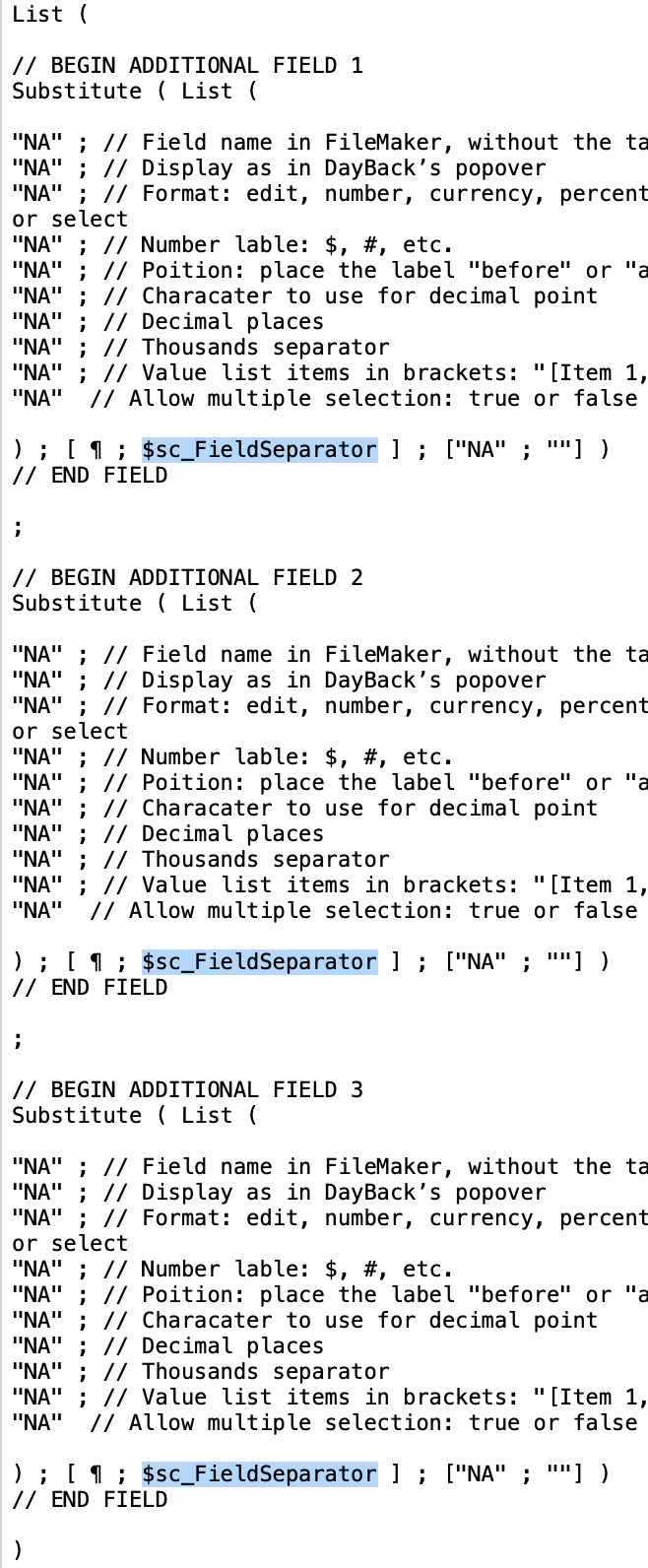

$$sc_AdditionalFields
additional fields
Screen Shot 2018-12-12 at 11.58.14 PM.png (247.8 KiB) Viewed 15526 times

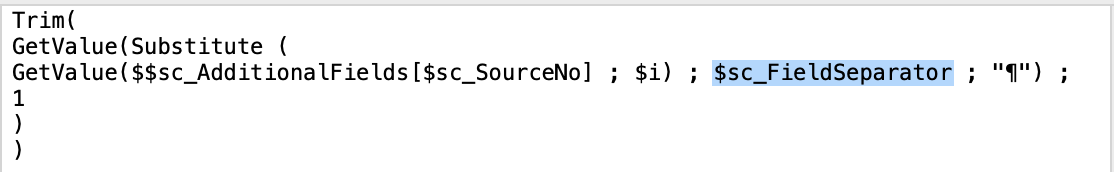

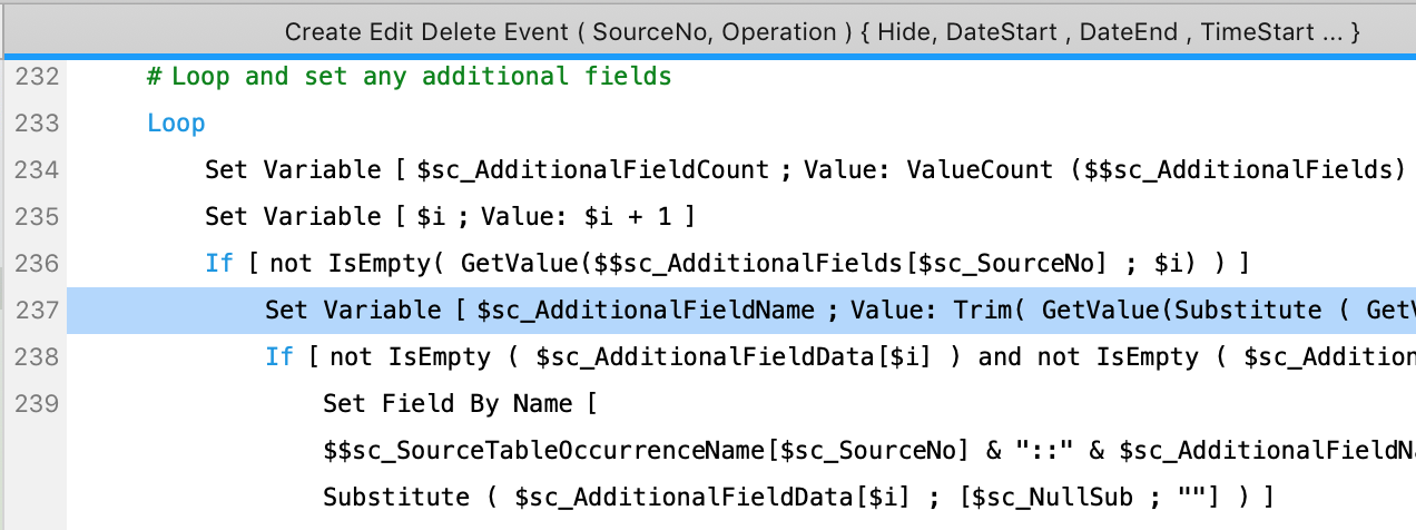

In your file edit the script "Create Edit Delete Event ( SourceNo, Operation ) { Hide, DateStart , DateEnd , TimeStart ... }". Scroll toward the bottom and find "Set Variable" script step for "$sc_AdditionalFieldName" as shown in the image below. Edit the set variable step.
additional fields
Screen Shot 2018-12-13 at 2.34.35 PM.png (125.61 KiB) Viewed 15526 times
Now just as before replace the comma substitution with $sc_FieldSeparator. Make sure to save your changes to the script when done.
substitution
Screen Shot 2018-12-13 at 2.33.22 PM.png (26.89 KiB) Viewed 15526 times
