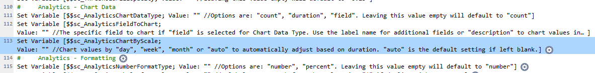

The following script will need individual script steps added to them. You can copy the script steps from the new DayBack file you downloaded. Then paste them into your script. For these you will not need to delete any existing script steps, just add the new ones as pictured below.
"Load Calendar Settings - On Startup --- Edit Configuration Here ---"
The script step "Set Variable $$sc_AnalyticsChartByScale" has been added. You can copy the script step from the newly downloaded file and add it to that script in your file. Or just make sure it looks like the screenshot below.

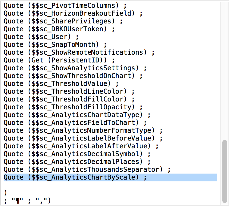

The following script will need individual script steps modified.
"Webviewer Settings"
The script step "Set Variable $sc_OptionsResult" has been updated. You can copy the contents of the script step from the newly downloaded file and replace the contents of that step in your file. Or just make sure it looks like the screenshot below.

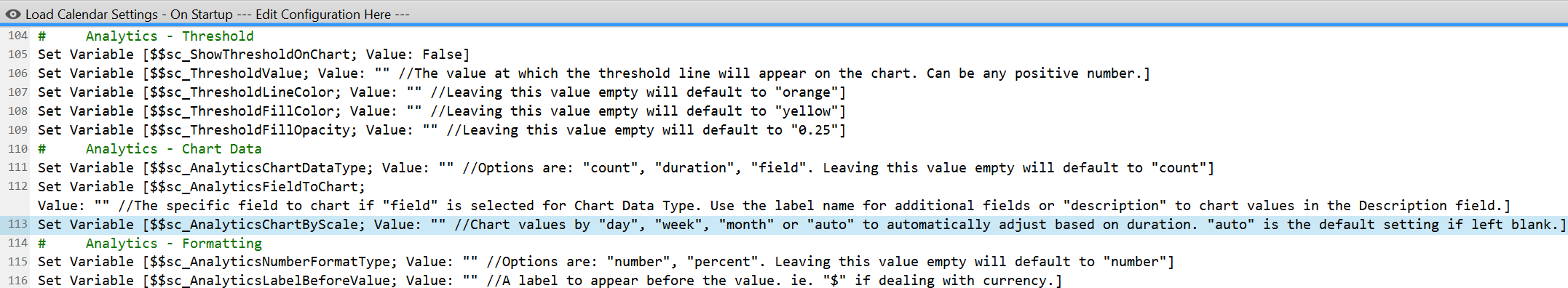

PostPosted: Wed Sep 12, 2018 9:15 pm
Hi Guys,
Just letting you know, that the screenshot for the script ""Load Calendar Settings - On Startup --- Edit Configuration Here ---""
shows a slightly different variable name to the step that is in the actual script, see screenshot.
sc_AnalyticsChartBy versus sc_AnalyticsChartByScale
PostPosted: Thu Sep 13, 2018 11:26 am
Thanks for the note on that! We've updated the screen-shot to match the script.
