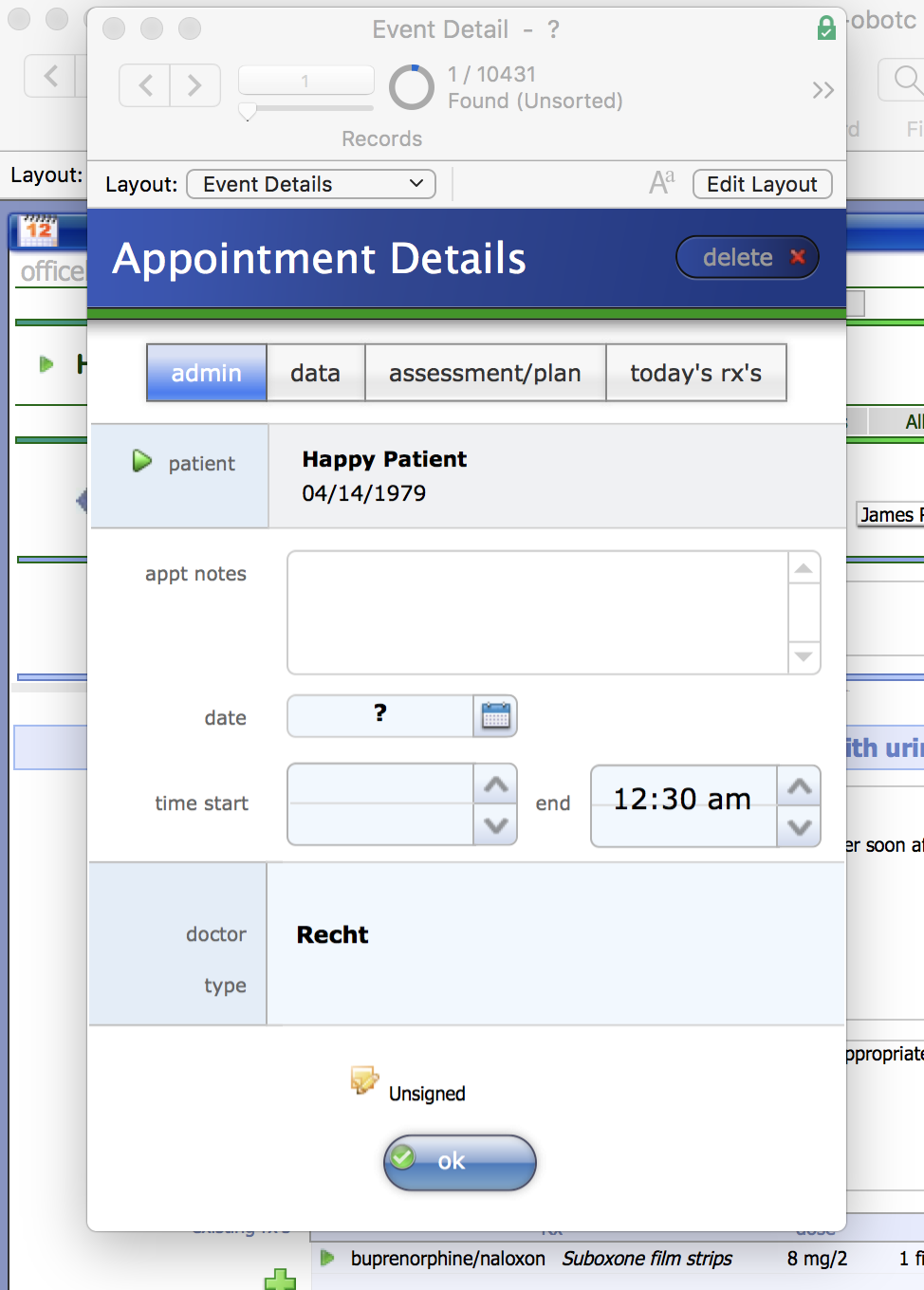

Since updating from 10.26 to 10.31 this week, we see a new problem when we attempt to create new events by clicking directly on the calendar. Please note that our DayBack is linked to our data via a "linking" integration. See attached screenshot. The mini window displays a "?" in the date field. It should display the currently selected date.
Any help appreciated!

The window name should be populated with the event start date, which is passed in on line 27 of the "Show Event Details From WebViewer" script using the "$start" parameter.

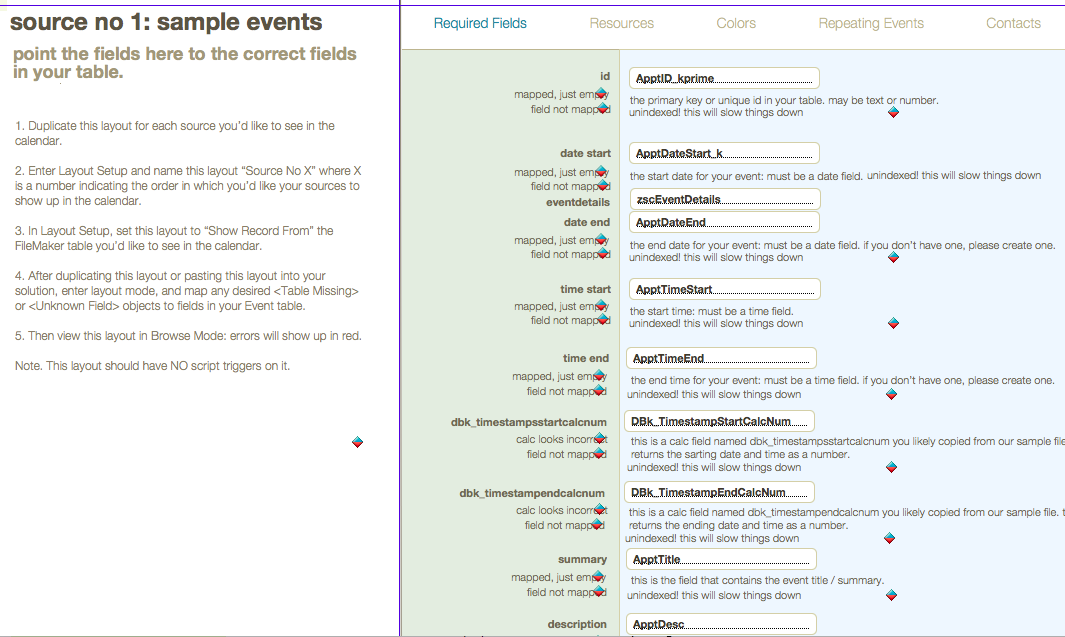

Most likely, the is that the DBk_WebViewerSource field in your event table has an invalid value assigned to the "sc_startDate" or "sc_StartTime" variable. Verify that you have the correct fields assigned to those values in the DBk_WebViewerSource field. (These should match the variables on your "Source No X" layout.

It looks to me like I have the correct fields assigned. Please see the additional screenshots I have attached here.

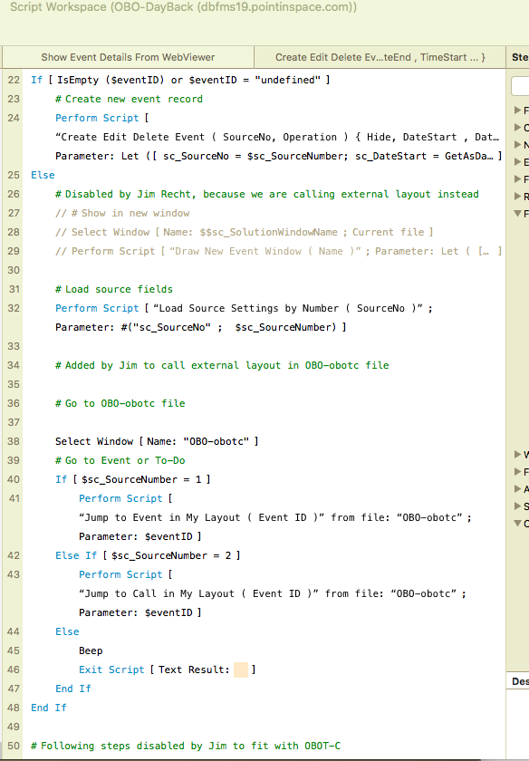

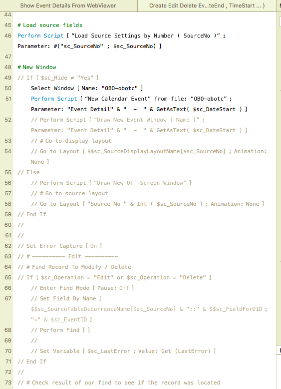

We have modified the "Show Event Details From WebViewer" script, because we need to call a script in the linked database file. So our modified script does not pass the variable you note at Line 27. We do not call the "Draw New Event Window" script. See the respective screenshots.
Also, we have modified the "Create Edit Delete Event" script. See screenshot of that script.

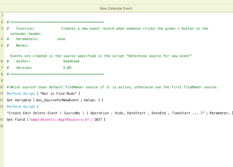

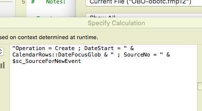

As you can see, we call the "New Calendar Event" script in the linked file. See screenshot of that script. Could the problem be here? See the screenshot of the calculation.
We haven't changed any of the scripts in the linked file. So I think the problem has to do with parameters that are passed to the linked file.

Here (attached) are the screenshots showing the called script and the relevant calculation.

Since you're not running our "Draw New Event Window ( Name )" script, you'll need to name the window accordingly in another script. I'm guessing you're doing this in your "Jump to Event in my Layout (EventID)" script, but the value you're passing to name that window is not valid.
This is something that would be best to step through the debugger until you get to the point in your scripts where the new window is created and named and see what the values/parameters passed to the window name are evaluating as.

The "CalendarRows::DateFocusGlob" value doesn't evaluate to anything at the time the "New Calendar Event" script is run. This is why the date shows as "?" in the window name.
You could either use your "$$CalCurrentDate" global variable to pass in the date, if that's being maintained, or you could pass in just "$sc_DateStart" as the parameter when you call the "New Calendar Event" script and then pass "Get ( ScriptParameter )" to the "Create Edit Delete Event..." script in your file to forward the event date into the script.

1. $$CalCurrentDate is only going to work if we happen to be looking at today's date, correct? But the whole point of the "click for new event" function is the ability to quickly create a new event on the date currently showing in the calendar -- am I missing something?
2. So I opted for your second set of instructions (passing $sc_DateStart to the "New Calendar Event" script, and "Get ( ScriptParameter )" to the "Create Edit Delete Event..." script).
3. And that does the trick nicely. Thank you so much!
