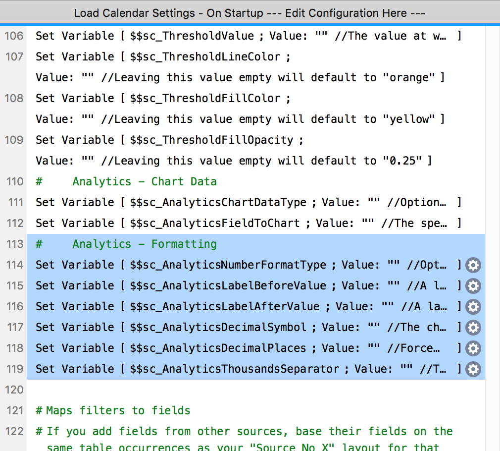

The following script will need individual script steps added to them. You can copy the script steps from the new DayBack file you downloaded. Then paste them into your script. For these you will not need to delete any existing script steps, just add the new ones as pictured below.
"Load Calendar Settings - On Startup --- Edit Configuration Here ---"
The script step "Set Variable $sc_PackageData" has been updated. You can copy the contents of the script step from the newly downloaded file and replace the contents of that step in your file. Or just make sure it looks like the screenshot below.

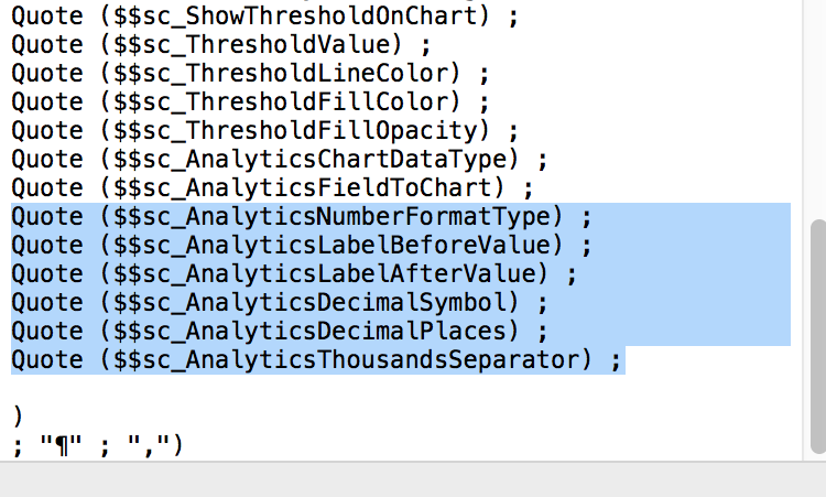

The following script will need individual script steps modified.
"Webviewer Settings"
The script step "Set Variable $sc_OptionsResult" has been updated. You can copy the contents of the script step from the newly downloaded file and replace the contents of that step in your file. Or just make sure it looks like the screenshot below.
