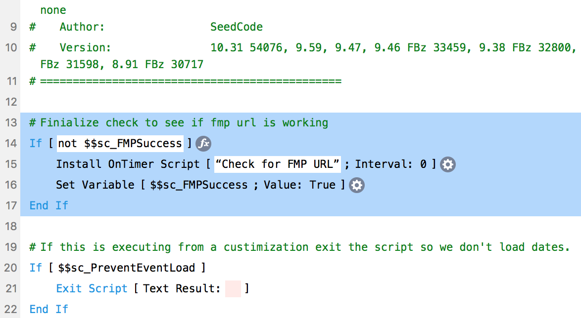

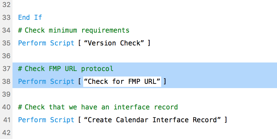

The following script will need to have script steps removed. So please highlight the script steps as shown in the image below and remove them from the script.
"Upon Opening" (Delete the Perform Script "Check for FMP URL" script step)
Note for SeedCode Complete: This script is called "Upon Opening DayBack" in SeedCode Complete.
Screen Shot 2018-05-01 at 3.40.40 PM.png (68.49 KiB) Viewed 35336 times

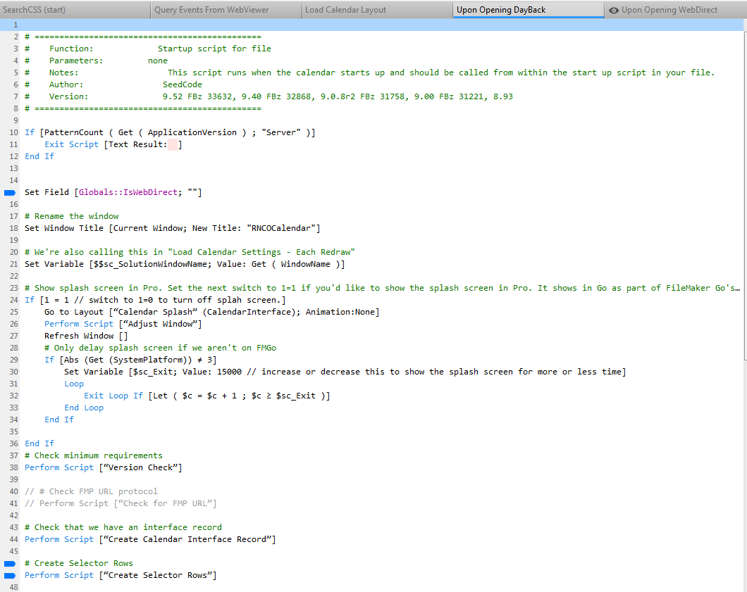

I am a bit confused with the last step of the instructions: it says that the script Upon Opening needs to be amended, but I have 3 Upon Opening Script. I have SeedCodeComplete.
Upon Opening
Upon Opening WebDirect
So I looked at the Upon Opening DayBack and figured this is the one that I need to amend, but I noted, that the version history mentioned that in version 9.69 a change was made, but I don't have this change.
I went back to all the update instructions, but I can't find any instructions on updating to 9.69. Did I miss something here?

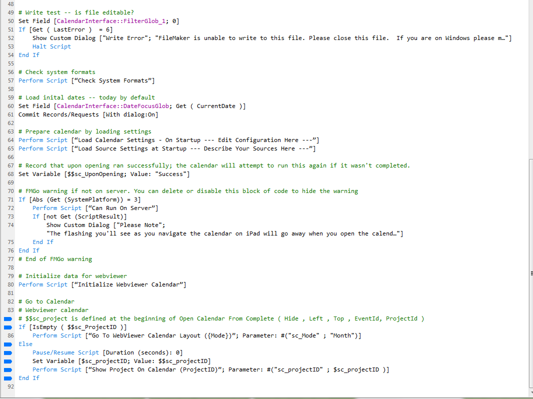

There are a couple of script steps different in my version. Attached screenshots, I marked the different lines with the blue marker.
Please could you kindly advise what I should do.

Thanks for the screenshots and details. I'll dive into this on my end and get back to you with more info.
PostPosted: Fri May 25, 2018 2:02 pm
The update that is commented as "9.69 FBz 39557" was actually applied in the instructions for 9.72 here: viewtopic.php?f=40&t=4286&p=11892#p11892
This update added the "Check for FMP URL" script step to the "Upon Opening" script. It was applied in our release of Complete, but we must have forgotten to add it to the comments section, but it doesn't look like you missed applying anything.
When applying DayBack changes that apply to the "Upon Opening" script, you'll want to modify the "Upon Opening DayBack" script as you predicted.
For this step, you'll just need to remove the "Check for FMP URL" script step and you should be all good.
Hope that helps!

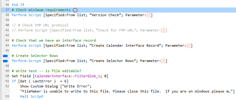

In the Upon Opening DayBack script I have a script step, that isn't in the original file:
Perform Script [Specified:From list; "Create Selector Rows"; Parameter: ] (see attached screenshot)
Is this related to my SeedCodeComplete verion? Or should I delete this step?
PostPosted: Wed Aug 08, 2018 7:24 pm
Yes, that's related to SeedCode Complete.
No, you should not delete that =)
