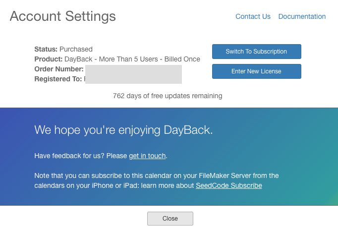

Sounds like the issue wis the version they have, but I cannot say for sure which the version is. I am slightly confused because not only can I not find out what version it is, but it says there are 762 days of free updates available, but no 'Check for updates' button! There should be no days of free updates - I am happy to send you the Order number back channel. See attached screenshot
Unfortunately I have made a lot of customisations so it looks like I will have to go through all the changes, once I can get the update. I hope I will be able to do this with the $299 'Extend In-App Updates' and in doing so I will get to see the button to update ( i am guessing it is not available because it is not eligible)

Thanks for the screen-shot. We had an issue in older versions of the calendar where the update days countdown would start counting up the days after reaching 0. That means the in-app updates for that license expired 762 days ago.
We recently changed the way our in-app updates work so that they are a subscription that immediately enables your calendar to be updated for a year. For the 5+ user license, the $299 extension will enable you to install the updates to the latest version.
