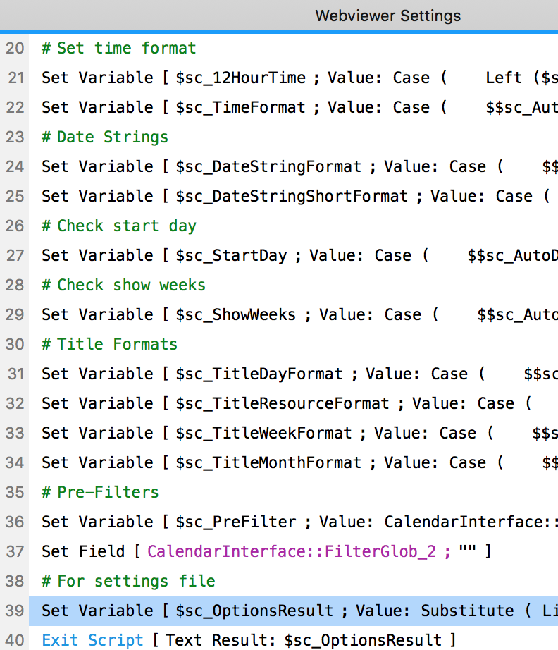

"WebViewer Settings" REPLACE the script step "$sc_OptionsResult"
Screen Shot 2018-01-19 at 10.31.45 AM.png (208.1 KiB) Viewed 30986 times

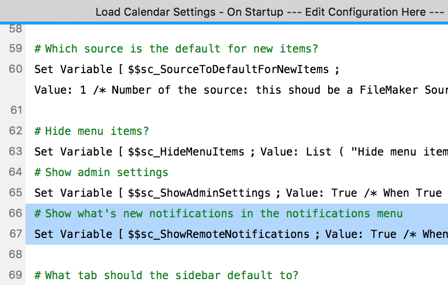

"Load Calendar Settings - On Startup" ADD the script step "$sc_ShowRemoteNotifications"
Screen Shot 2018-01-19 at 10.32.07 AM.png (131.13 KiB) Viewed 30986 times

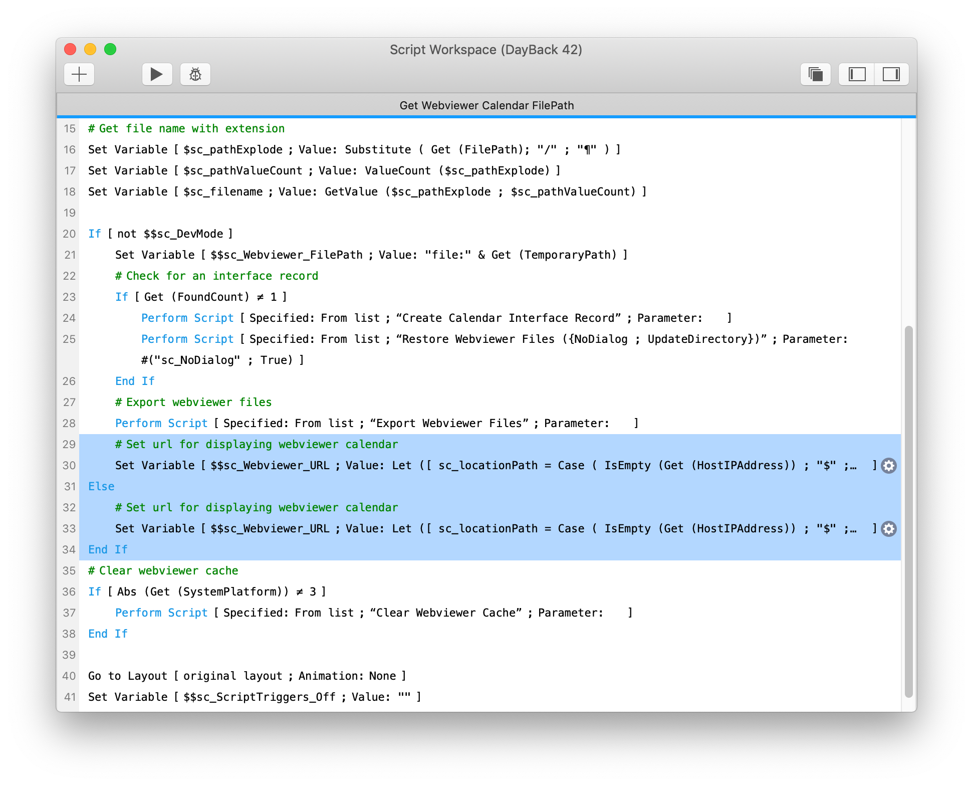

"Get Webviewer Calendar FilePath"
Delete the "Set Variable [ $$sc_Webviewer_URL..." script step from line 31 of your copy of the script, then copy the highlighted lines below from the new version of DayBack to corresponding file in yours.
