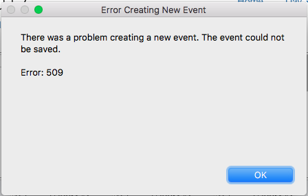

Hello!
Just this morning I started to experience a variety of errors when adding events or moving existing events around in the calendar. I get a slightly different error message based on what I am trying to do, but none of the changes I make are being saved.
I have attached a couple screenshots of the errors, and it appears this issue is with how the create/edit scripts are interacting with the calendar, but I did not want to start changing anything without a better idea of where to look. I appreciate any help you can offer!
Nick
Using the Plus Button or New Event button to create a new event:

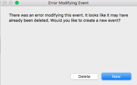

Moving an existing event to a new date:

PostPosted: Fri Nov 10, 2017 9:08 am
Hi Nick,
Sorry you're running into this! And thanks for the screenshots: they're a big help. Normally I'd take the 509 error literally and say that you have a field validation issue that is preventing a new event from being saved--and that may be the case--but your second screenshot seems to point to the ID of the event you're editing not being quite what DayBack thinks it is.
That ID is mapped in two places in DayBack: 1) on the Source No X layout, and 2) in the calculated field "DBk_WebViewerSource" that you added to your events table. My guess is that a different fields is mapped to the ID in those two places. They'll want to use the same field.
If that isn't it, email us at support at seedcode.com and we'll send instructions for letting us take a look at the file. It may be something we can figure out quickly once we see the file.

PostPosted: Fri Nov 10, 2017 9:24 am
Thanks for the quick reply John! It was just a validation issue- I recently adjusted a field to be required and had not populated it in all the records yet. It is fixed now, and I know how to prevent it from happening again if I run into this error. Great info, and thank you again for your help!
