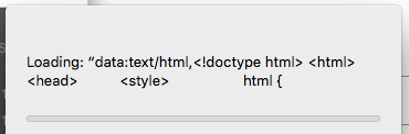

I am having an issue printing the calendar ever since I updated to 9.91, and this update did not fix it. I have the same issue when trying to print from a newly downloaded version of 9.92 for this update.
I already set up a layout and script that have the required edits to the calendar layout for printing, and it was working up until now, but now when I try to print (or even try to look at it in preview mode) I get an error message that prevents the calendar from loading. I have attached a screenshot of the error, and once it pops up the program freezes. We print our calendar quite a bit, so I hope you can fix this or help me out.

Thanks for reaching out to us. Since I wasn't able to reproduce this in a clean copy of DayBack, it looks like something that's going to take some troubleshooting. I've created a case in our support system and you should receive an email shortly with some more questions.

Just wondering if you came up with an answer that may help me. When I go to print or preview mode FileMaker produces an empty dialog box (just white) and appears to hang. But if I abort with cmd+ . preview mode comes up. Similarly if printing it prints.
I have tried this on a new layout with no script triggers and only the calendar web viewer on screen with script debugger open - no scripts are triggers.
OSX10.11.6 and FMP 14 and 15 - latest updates.

Yesterday we were able to verify this issue is occurring only on Mac systems and was introduced in one of our more recent builds. A bug case has been created and a fix will be released in a future version.
For now, the best way to print the calendar layout would be to take a screenshot of the view and print or save to the file format of your choosing.

just tested 9.94 to see if the problem is resolved, unfortunately not. I hope this is what you were expecting!

The 9.94 update included some changes that were already in the pipeline. Unfortunately, it did not include a fix for the printing issue.
I wish I had better news for you. We do have plans to work on a fix for the printing issues in a future release, but we don't yet know exactly when it can be accomplished.
When we do release a fix, it will be included in the build notice. We've also got a note on the case to update the users that have notified us they are affected.

Great news, our latest DayBack update includes a fix for the printing issue you were experiencing!
This latest build is just an in-app update, but if you're upgrading from 9.92 or earlier, there are some script updates that will need to be applied in order for the calendar to work properly. You can take a look at our Version History documentation for a description of each build and instructions on the necessary script updates: http://www.seedcode.com/pmwiki/index.php?n=DayBackForFileMaker.VersionHistory

tested and all great. Thanks for the quick fix
