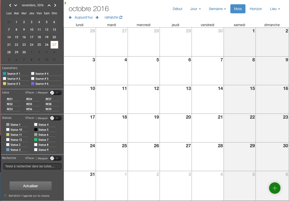

Hello Dan,
I just want to share with everybody what I did to add a custom Sidebar reflecting what my user really needs. You and KC were very helpful by giving me some hints in order to incorporate different filters. Here is a list of some topics regarding this Sidebar :
  • No tabs! Everything in one place
  • It's easy to navigate from year-to-year and directly to a month with the mini-calendar
  • The search text looks to the whole content of any event
  • The calendar may be refresh automatically (as soon a filter is set) to get a fresh look of the calendar more rapidly
  • Color coding of Calendars and Status near each selection
It should be note however that the calendar is not refreshed as rapidly than your solution. Since the filtering mechanism is, from my understanding, executed in the webviewer, your solution is the best one. Also the auto-refresh mechanism may takes time with slow internet connection on WAN.
Nothing's perfect but it fits what my user wants!
Hope it may helps someone,
Denis
Capture d’écran 2016-11-27 à 15.42.24.png (121.55 KiB) Viewed 12685 times
PostPosted: Sun Nov 27, 2016 9:04 pm
Denis,
I love how this turned out! Thanks so much for sharing it!!
