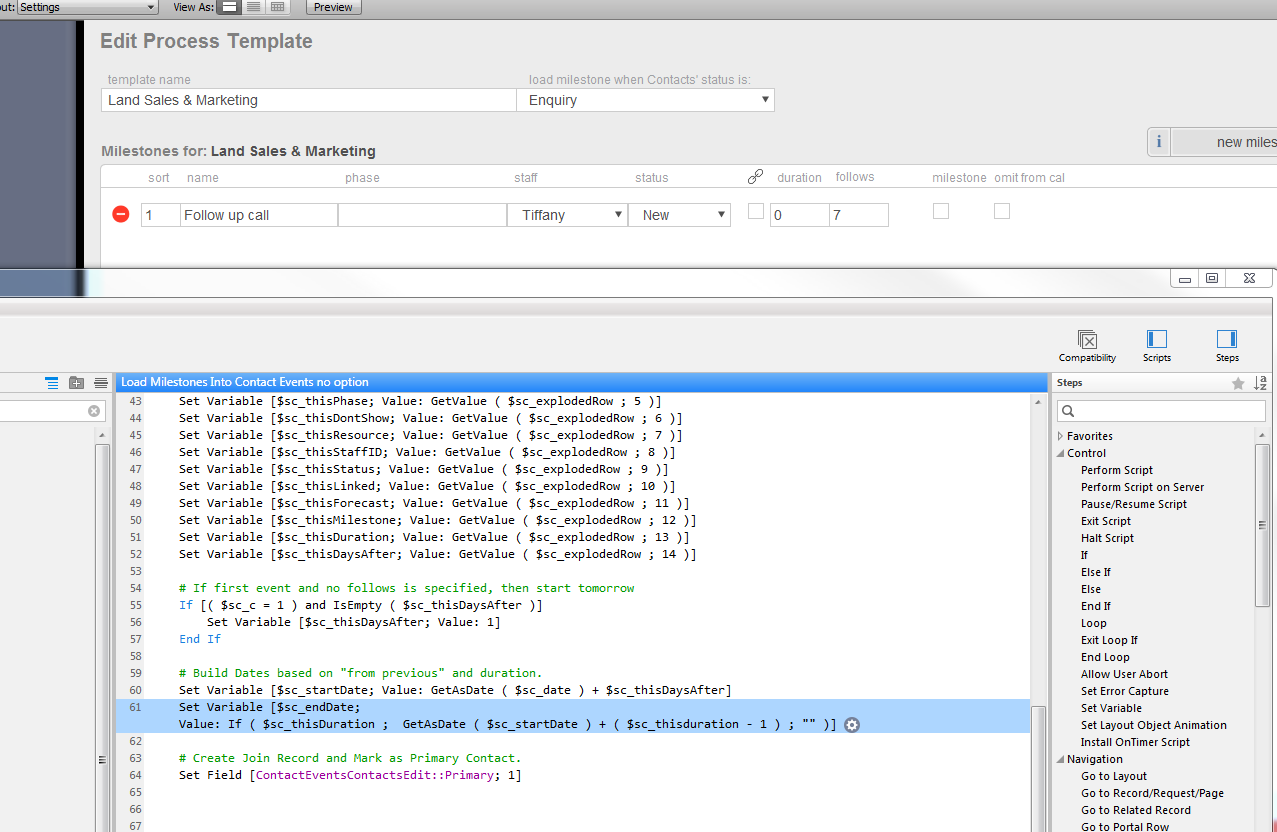

I am suddenly having my end date set to ? when the event is created automatically through Milestones.
This then results in the event not showing on the calendar.
I haven't done anything to the script or milestones, the only thing I did recently was updating to the latest version of Dayback.
Attached a screenshot of the milestone and the script step with the end date creation.
Please can you assist, how I can avoid the question mark in each event.

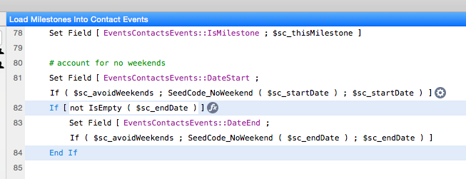

Thank you very much for letting us know about this. I was able to find the cause of this issue, which appears to only happen when the avoid weekends option is enabled and the milestone duration is set to 0.
To correct this, in the the "Load Milestones Into Contact Events" script, wrap the Set Field step for EventsContactsEvents::DateEnd in an IF step as highlighted in the attached screenshot. This will leave the end date empty as expected when the milestone duration is set to 0.
If you use Project milestones, make the same modification around the ProjectContactsEdit::DateEnd Set Field step within the "Load Milestones Into Project Events" script. Let me know if that works for you.
Screen Shot 2016-10-20 at 11.47.56 AM.png (46.76 KiB) Viewed 10787 times
