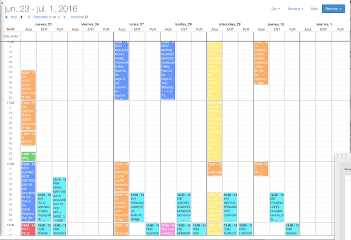

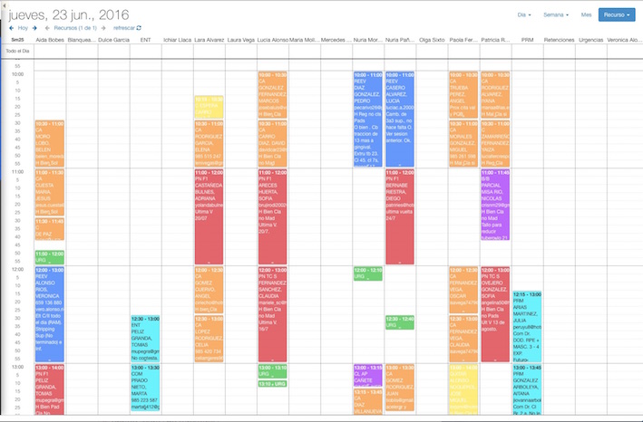

PostPosted: Thu Oct 13, 2016 11:46 pm
Hello,
I've have a similiar question about resource views.
I've defined 20 resources and 7 display days in "Load Calendar Settings - on Startup" script. All works fine.
But I want change the number of viewed days from navigation script when user arrive to "Resource Sched Vert". Sometimes I need to show 3 or 4 resources in 7 days view and sometimes 20 resources in 1 day view.
I know, normally you can change this through "Resource" button, but the correct way in our context is change this parameter in a transparent way from user point of view.
In example, if you want to see general state of today resources you must press one button and arrive to the 20 resources and 1 day view (Image#1). In other hand, if you want change an appointment you must press button in this appointment and arrive to 3 resources and 7 days view (Image#2). In this case the resource numbers can be variable from 1 to 5.
I want use this system in other ways but if you can help me with this example that can be the best start point.
Can you help me please?
Image#1
resources20_days1
recursos x 20 dias x 1.jpg (98.71 KiB) Viewed 23588 times
Image#2
resources3_days7
recursos x 3 dias x 7.jpg (92.68 KiB) Viewed 23588 times
Thank's in advance
PostPosted: Fri Oct 14, 2016 7:37 am
Love those screenshots, Angel! Thanks for those.
This feature is definitely on our radar--an in our plans--but currently, the only way to change the number of days/resources is to use the drop-down menu OR set the values in the configuration script and then call Upon Opening again. I know that, instead, you need to be able to change these settings with your own scripts.
I can't give you a date for when we'll get that in the product, but I know it's needed.
