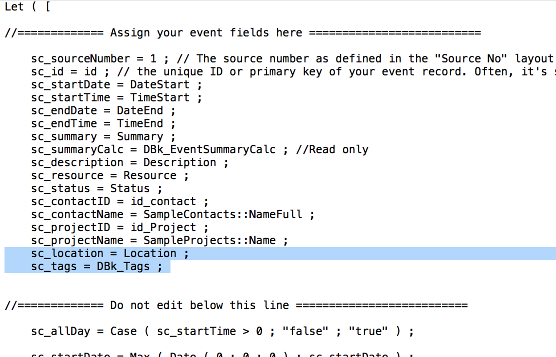

3. Edit the calculation definition for the "DBk_WebViewerSource" field in each of your tables.
3.1 Add the two lines shown in blue in the screenshot below. Replace " = Location" with " = YourFieldName" if you're using an existing field of yours instead of location.

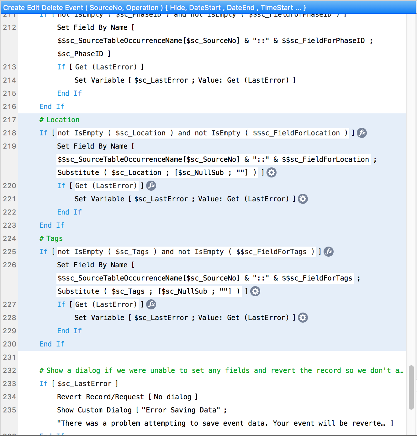

5. Finally, edit the script "Create Edit Delete Event ( SourceNo, Operation ) { Hide, DateStart , DateEnd , TimeStart ... }" adding the lines shown in blue below, copying these from the new version of DayBack you downloaded to begin these mods.
