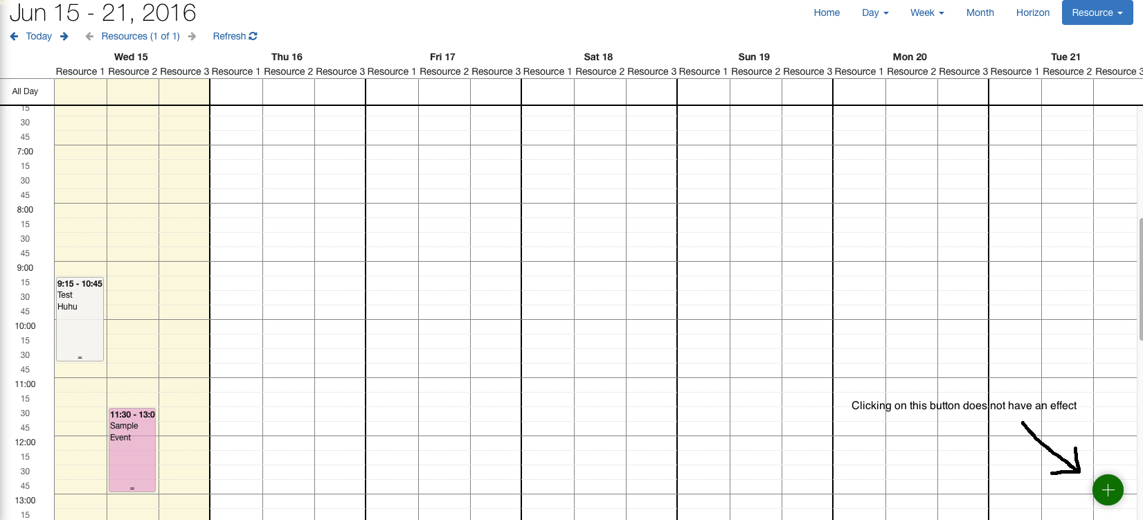

When I'm in the "Resource" -> "Schedule"-View, clicking on the green (+)-Icon in the bottom right of the window does not have an effect. When I switch back to another view (e.g. the Day view), I can see that a new event without title and description has been created.
I think that this error occurs because a new event is not assigned to a specific resource, so the calendar doesn't display it at all.
By double clicking on a cell in the calendar, I can create new events in that view.
Is there a solution or workaround for this problem?
Screen Shot 2016-06-15 at 14.07.40.png (83.69 KiB) Viewed 7606 times

Thanks for reaching out here about this! You're absolutely right -- when just clicking the button, the new event will not have a Resource assigned automatically. So, on the Resource views, clicking the button will not do anything, unless you have a "none" column for the new event to fall into.
However, the green plus button can also be dragged to drop a new event in place. While on a Resource view, try dragging the plus button to drop a new event on the desired resource. Let me know if that works for you!
