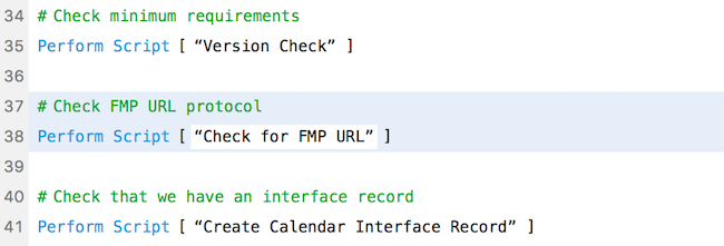

We added a check to make sure the FMP URL protocol is working on startup. Please edit the "Upon Opening" script and add the following script steps as shown in the image below.

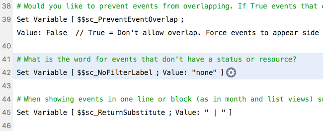

We made one small addition to the "Load Calendar Settings - On Startup" script. If you haven't modified this script you are welcome to just copy the contents of the script and paste into your file as you have been doing with the other scripts. If you made changes please add the following lines that are highlighted in the screenshot below. These script steps can be copy and pasted from the new updated file.

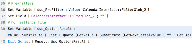

We also made a change to the "Webviewer Settings" script. Again, if you have not made any edits to this script feel free to copy and paste replacing the contents of the script. If you have made changes or want to play it safe you will just need to copy and paste replacing the contents of one calculation for a set variable. Edit the set variable script step "$sc_OptionsResult" as shown in the screenshot below and replace the contents with the new DayBack file.

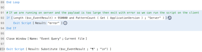

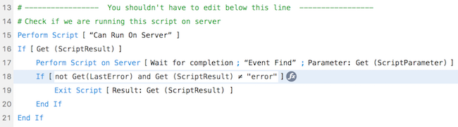

We made a couple of changes to the "Event Find" script. The changes fixed an issue that could cause problems if the event payload was too large over PSOS.
Edit the if statement in the script so it looks like the highlighted line in the image below. To make it easy you can just copy and paste the contents of the if statement from the same script in the new file.
Then add a new if statement near the bottom of the script as shown in the image below. Again it is easiest to just copy the script steps from the new file and paste them in the same place in your file.

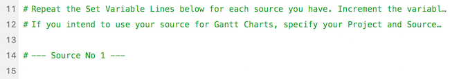

We added a couple of options to the "Load Source Settings at Startup --- Describe Your Sources Here ---" script. To enable these options find the section for each source starting with source number 1.

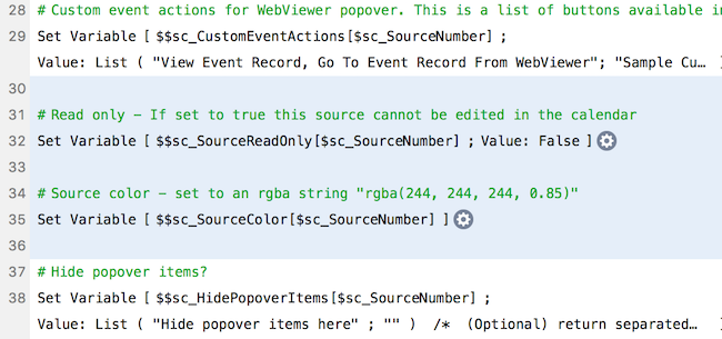

Then add the following lines to your file (copy them from the new file) as shown in the image below.
Feel free to customize the values of the variables your are adding. The source color will override any default event colors already set so if you don't want default event colors to change you can either update the $$sc_SourceColor variable to a new value or just remove the value so the variable will not get set.
Repeat the same steps for each source you have defined. By default DayBack ships with two sources.

Then you will need to change a variable name in the "Load Calendar Settings - On Startup" script. Change the variable $$sc_NoStatusLabel to $$sc_NoFilterLabel. If you don't have a variable $$sc_NoStatusLabel you may have missed that step before in which case follow the directions below to make sure you didn't miss anything..
Then replace the variable contents of the set variable step "$sc_OptionsResult" in the script "Webviewer Settings" with the contents from the 9.72 file.
