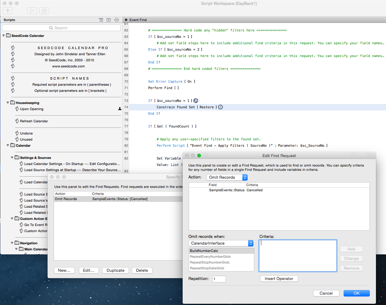

Sure thing. I've attached a screenshot of a possible modification to the Event Find script. It is easier to omit records after the initial find is completed, so I've added a Constrain Found Set step (set to Omit Records), after the section we have labelled for hard-coded filters.
You could also wrap the calculations of your DBk_TimestampStartCalcNum and DBk_TimestampEndCalcNum fields in a Case statement, so that these fields calculate to empty if the event Status is "cancelled". That way, these events will be excluded from the find (without modifying the Event Find script).
I hope that helps. Keep us posted with any other questions.

PostPosted: Wed Mar 02, 2016 6:40 pm
thanks! that worked great.
