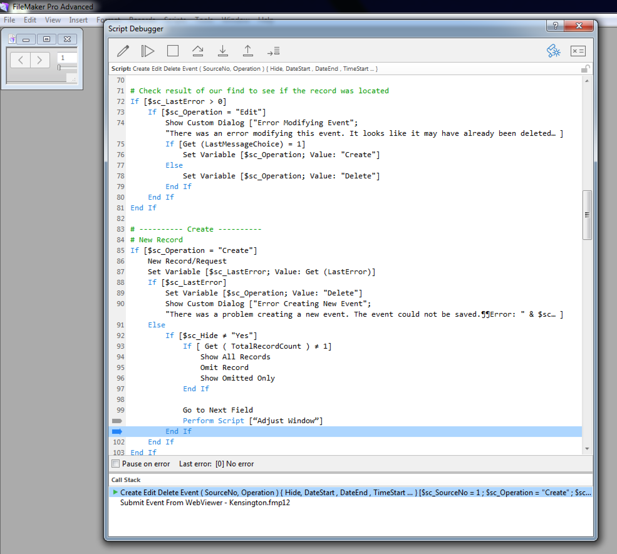

Still getting window issues. On Windows 7 Pro and FileMaker Pro 14 Advanced - all fully patched.
Users are double clicking on the web viewer and selecting New Event from the popup. This calls the Submit Event From WebViewer script.
It goes through the loop and then hits the Create Edit Delete Event {....} script. When it hits line 45 and called the Draw New Off-Screen Window subscript the window is resized to what the final state ends up being. The window is the height of the tool bar and I can see about 1/2 of the record count box.
At line 92 there is an IF statement "If [$sc_Hide <> "Yes"]
The Adjust Window subscript at line 100 is being jumped over.
Screen Shot 2016-01-11 at 3.48.25 PM.png (251.9 KiB) Viewed 17143 times

Thanks so much for the additional details here. Since your main calendar window is being resized when another window is opened (i.e., the off-screen window in the Create Edit Delete Event script), this does sound like an issue with maximized windows in FileMaker for Windows. If you resize the small window without using the maximize button (simply dragging instead), does the calendar window stay at the size you set while using the calendar?
On Windows, if a FileMaker window is maximized, and another window is opened, the maximized window will be un-maximized and resized. Not using the built-in "maximize" window option should get around this issue. To still have the main calendar window appear maximized, see the instructions at this link:
http://www.seedcode.com/pmwiki/index.ph ... mizeWindow
Let me know if this helps!
Dan

There was a random Maximize Window that only got triggered under certain conditions. Changed that to a Resize To Fit and all seems good now.
Thanks for all the help.
