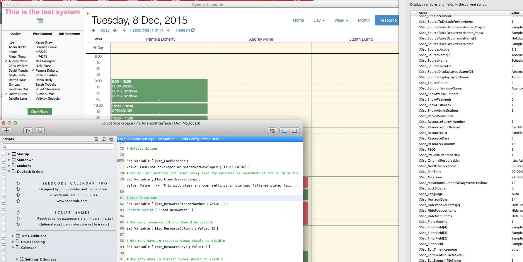

I have just updated to 9.63 (thank you!) and was hoping to be able to specify the number of visible days when the users first open the calendar. The variable is being set but not being reflected in the calendar - do I have to change anything else?
Screenshot attached, after a quit and relaunch.
Tim
[img]
[/img]
PostPosted: Tue Dec 08, 2015 3:36 pm
Hi Tim,
Glad you are excited about the upgrades to DayBack! Thanks so much for reaching out on this.
We suspect that maybe some of the steps in upgrading to v9.61 may not have been completed, in particular the last step at these instructions (changes to the $$sc_OptionsResult set variable step):
viewtopic.php?f=40&t=4212&p=11605#p11605
Review these upgrade instructions to make sure all the changes have been made. Let me know if this helps!

PostPosted: Wed Dec 09, 2015 12:48 am
Sorry Dan, that was done
I have double checked and redone that step, calc for the variable $sc_OptionsResult is
Substitute (
