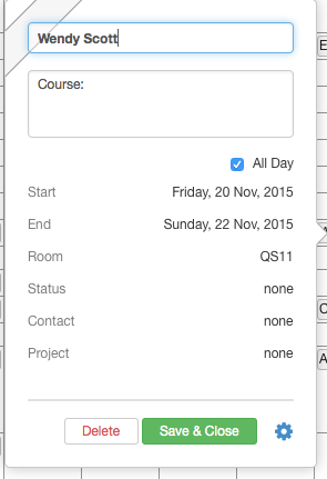

One issue I can see is that the summary and description in DayBack are editable. These really aren't editable in my solution. I can work around by showing a error message and then discarding any change but would be better if this was "view only". Is there a setting for that?
Screen Shot 2015-11-13 at 16.05.45.png (27.88 KiB) Viewed 17849 times
PostPosted: Fri Nov 13, 2015 10:28 am
You can't make these fields read-only via CSS, sadly. You can, however, map these two other fields the user *can* enter. You then change the field labels using translation: http://www.seedcode.com/pmwiki/index.ph ... ranslation
You could also switch from using the in-webviewer popover to using your own FileMaker layout for editing events: http://www.seedcode.com/pmwiki/index.ph ... entLayouts
And you're right that doing it with access privileges works but it's misleading to let the user into the field to begin with. =(
