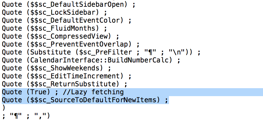

We made one small change to scripts in this version to fix an issue where DayBack was not using the proper default source for the new events selection. Please make the following change...
In the "WebViewer Settings" script scroll to the bottom and edit the set variable script step "$sc_OptionsResult". Please add two additional lines to the bottom of the substitute calc :
Quote (True) ; //Lazy fetching
Quote ($$sc_SourceToDefaultForNewItems) ;
The result should look like the image above. Once the edit has been made save the script changes.
