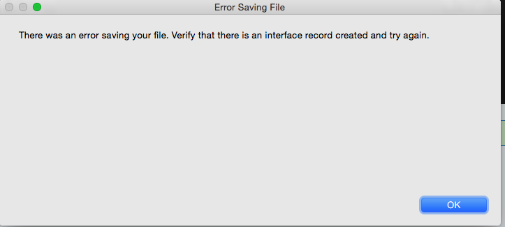

Hi
When trying to edit (or activate another one) the theme file I get an error message: see screenshot attached
Thanks for looking at it
Juergen
PostPosted: Thu Jul 02, 2015 1:26 pm
If creating an interface record didn't fix the problem then I'm not sure what else would cause that error message. Send me your file at support@seedcode.com and I'll have a look.

PostPosted: Fri Jul 03, 2015 4:56 am
Hi, Jeff
If you still have the file I sent the day before yesterday, you'll find the issue there.
Regards
Juergen
PostPosted: Mon Jul 06, 2015 5:05 am
There is a broken "Go to Layout" step in your "Save Theme File (Rename)" script. It should go to the "WebViewer: Under The Hood" layout.
Posts: 9
Joined: Fri Jun 26, 2015 10:12 am
PostPosted: Mon Jul 06, 2015 5:20 am
Hi, Jeff
Thanks a lot. I wonder how this happened.
Juergen
PostPosted: Mon Jul 06, 2015 8:03 am
Most likely the layout either didn't exist or had a slightly different name from the original when you copy/pasted the script.
